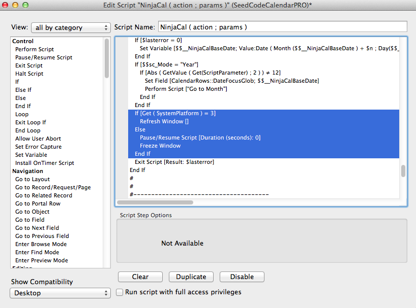

Hi, there is a little problem with the mini calendar on the "Calendar Ipad" layout.
By clicking on the left arrow, the previous month isn't showed; nor by clicking on the right arrow, the next month. That occurs only accesing by Ipad; when I open the same layout from a computer, the problem doesn't exist.
I didn't change the script "NinjaCal ( action ; params )"
Thanks for your help
damian
PostPosted: Thu Jan 17, 2013 1:01 pm
Hi Damian,
The issue is that "Freeze Window" does not refresh the screen on Go like it does in Pro, so you need to explicitly call the "Refresh Window" step (see screenshot below).
