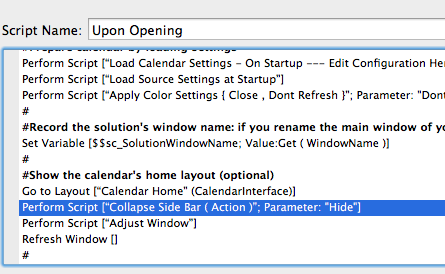

SETTING that Default No Side bar,
i am having problem finding what you say
You suggest..
Check out the script "Show Side Bar by Preference". NO SUCH FIND THIS NAMED
Looked in """"Load Calendar Settings - On Startup --- Edit Configuration Here ---
I don't see anything mention regarding this side bar HIDE or SHOW option
I did find the Collapse side bar (action) Script
btw whats the (action) mean? just a note!
Where is this action parameter initiated?
looks like script that has the code... IF Hide or Show the sidebar

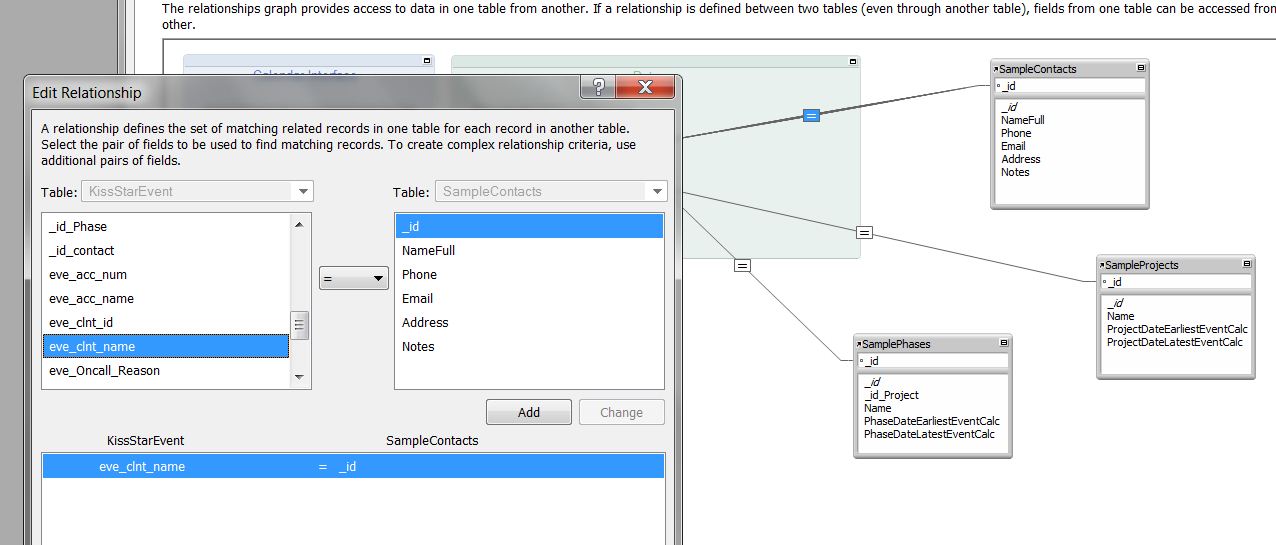

more.... I think looking at the relationship of the projects, etc stuff.. is my problem
I the source-1 ...looking at tab Gantt,
I DO HAVE exactly the same field names as the sampleevent fields..
but looking at the relationship... my linked is obvious WRONG...
and expect all 3 files... contact, projects, phases not installed
Your demo demonstrates that works... but, and for me i would expect it to work too
and not have to dig in your code to debug this.. so the demo suggest..
I would think my version following your instructions should be the same...
I am missing instruction or more info on these projects, etc stuff.. installing
Just asking,.
Is there somewhere else i need to set in your code..
or just map my relationship to better fields?
And is there any doc i missed telling me this?

That last screen shot you have should probably relate the contact ID on the left side to the _id on the right side. But I am having a bit of a hard time following your descriptions so I can't say for sure.
And I do sympathize with having a hard time following the instructions: we've done our best with those and some people can get in their and follow them just fine. Other folks just need to take their time, read through them again, and they'll get things working.

Still can find a simple way to either have full large view layout to HIDE the darn side bard
I HAVE LOOKED AND LOOKED UNTIL I PAST OUT LAST NIGHT... Please
this deals with calling Callaspe Script that get a Parameter passe HIDE or SHOW... where is the switch for this....

Linking apparently broke the links to the project and phase.. contacts are still there.. looking at those 3 extra files in relationship to my event file, 4 first time,
Found I do not have a project list first column of gantt
Here's prob why,, bring the event file over.. the linking of, and myself populating the event from my application
I have removed all the events, zero the records more than once.

Regarding the sidebar, the easiest way to make the no-sidebar version the default is to call the scrip "Collapse Side Bar ( Action )" at the end of the Upon Opening script with the action "Hide" (see below). The calendar remembers this "preference".
Hope that helps.
