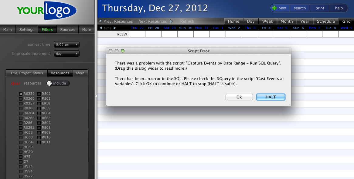

I just finished going through the quick integration for Calendar Pro. Opted to not include Gantt. At the end all was ok with my events. My next step was to get to adding my resources and modify filtering process. After, changing the "Resource" Value List and after I ran upon opening script, I attempted to filter to a resource. Everytime I select a resource a Script Error Dialogue prompt pops up.
"...problem with script "Capture Events by Date Range - Run SQL Query...error in SQL...check $Query in the script 'Cast Events as Variables.'...."
Did I miss something? I also tried to replace the Resource value in the --- IF IsEmpty ( $sc_Resources )--- condition. Inevitably I would like to move on to the other resource Filtering instructions and to have full integration. Just got stuck at this point. Thanks.

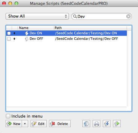

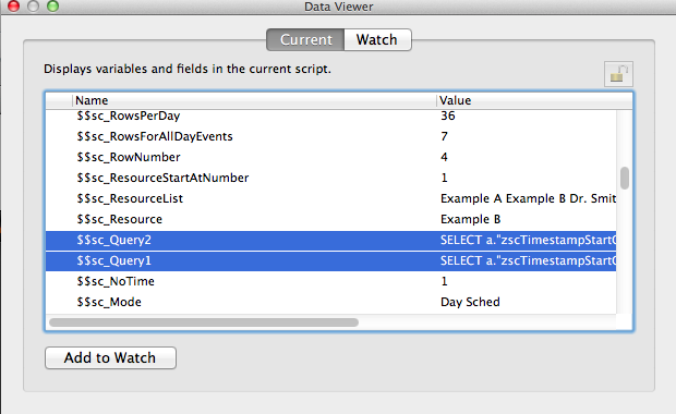

We have some troubleshooting tools for looking at this if you have FileMaker Advanced. If you do, then we have a script called Dev_On which just tells some scripts to not clear the global variables they use. If you run this script and then cause the error. The variables that have the queries that caused the error are still there and we can try to identify why they failed.
The Script:
The Queries in the Data Viewer:
Data Viewer.png (54.63 KiB) Viewed 13921 times
And the Query Body:

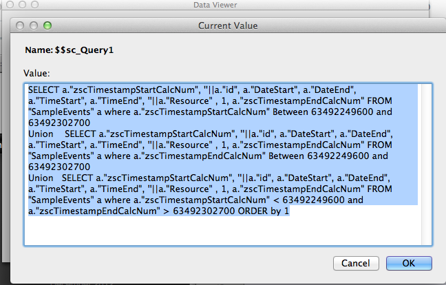

If you could paste the queries for $$sc_Query1 and $$sc_Query2 here, we might be able to figure it out. If you don't have advance, then send me an e-mail at support@seedcode.com.

Thanks. I ran the dev1 program. Error still occurred. I also made the full integration instead of the quick just one and just finished and have similar error.
On the quick integration ...
Query1 Reads
SELECT a."zscTimestampStartCalcNum", ''||a."__900RANumber", a."_920DateOut", a."_925DateDueIn", a."_921TimeOut", a."_926TimeDueIn", ''||a."_915_200aUnitNumber" , 1, a."zscTimestampEndCalcNum" FROM "SampleEvents" a where a."__900RANumber" LIKE '-----' and a."zscTimestampStartCalcNum" Between 63492249600 and 63493545599
Union
SELECT a."zscTimestampStartCalcNum", ''||a."__900RANumber", a."_920DateOut", a."_925DateDueIn", a."_921TimeOut", a."_926TimeDueIn", ''||a."_915_200aUnitNumber" , 1, a."zscTimestampEndCalcNum" FROM "SampleEvents" a where a."__900RANumber" LIKE '-----' and a."zscTimestampEndCalcNum" Between 63492249600 and 63493545599
Union
SELECT a."zscTimestampStartCalcNum", ''||a."__900RANumber", a."_920DateOut", a."_925DateDueIn", a."_921TimeOut", a."_926TimeDueIn", ''||a."_915_200aUnitNumber" , 1, a."zscTimestampEndCalcNum" FROM "SampleEvents" a where a."__900RANumber" LIKE '-----' and a."zscTimestampStartCalcNum" < 63492249600 and a."zscTimestampEndCalcNum" > 63493545599 ORDER by 1
Query2 Reads
SELECT a."zscTimestampStartCalcNum", ''||a."__900RANumber", a."_90100FKFullNamePhone", ''||a."_915_205Model" FROM "SampleEvents" a where a."__900RANumber" LIKE '-----' and a."zscTimestampStartCalcNum" Between 63492249600 and 63493545599
Union
SELECT a."zscTimestampStartCalcNum", ''||a."__900RANumber", a."_90100FKFullNamePhone", ''||a."_915_205Model" FROM "SampleEvents" a where a."__900RANumber" LIKE '-----' and a."zscTimestampEndCalcNum" Between 63492249600 and 63493545599
Union
SELECT a."zscTimestampStartCalcNum", ''||a."__900RANumber", a."_90100FKFullNamePhone", ''||a."_915_205Model" FROM "SampleEvents" a where a."__900RANumber" LIKE '-----' and a."zscTimestampStartCalcNum" < 63492249600 and a."zscTimestampEndCalcNum" > 63493545599 ORDER by 1
__________________________________
On the fully integrated one ...
Query 1 Reads
SELECT a."zscTimestampStartCalcNum", ''||a."__900RANumber", a."_920DateOut", a."_925DateDueIn", a."_921TimeOut", a."_926TimeDueIn", ''||a."_915_200aUnitNumber" , 1, a."zscTimestampEndCalcNum" FROM "SampleEvents" a where a."zscTimestampStartCalcNum" Between and
Union SELECT a."zscTimestampStartCalcNum", ''||a."__900RANumber", a."_920DateOut", a."_925DateDueIn", a."_921TimeOut", a."_926TimeDueIn", ''||a."_915_200aUnitNumber" , 1, a."zscTimestampEndCalcNum" FROM "SampleEvents" a where a."zscTimestampEndCalcNum" Between and
Union SELECT a."zscTimestampStartCalcNum", ''||a."__900RANumber", a."_920DateOut", a."_925DateDueIn", a."_921TimeOut", a."_926TimeDueIn", ''||a."_915_200aUnitNumber" , 1, a."zscTimestampEndCalcNum" FROM "SampleEvents" a where a."zscTimestampStartCalcNum" < and a."zscTimestampEndCalcNum" >
Union SELECT b."zscTimestampStartCalcNum", ''||b."id", b."DateStart", b."DateEnd", b."TimeStart", b."TimeEnd", ''||b."Resource" , 2, b."zscTimestampEndCalcNum" FROM "ToDoList" b where b."zscTimestampStartCalcNum" Between and
Union SELECT b."zscTimestampStartCalcNum", ''||b."id", b."DateStart", b."DateEnd", b."TimeStart", b."TimeEnd", ''||b."Resource" , 2, b."zscTimestampEndCalcNum" FROM "ToDoList" b where b."zscTimestampEndCalcNum" Between and
Union SELECT b."zscTimestampStartCalcNum", ''||b."id", b."DateStart", b."DateEnd", b."TimeStart", b."TimeEnd", ''||b."Resource" , 2, b."zscTimestampEndCalcNum" FROM "ToDoList" b where b."zscTimestampStartCalcNum" < and b."zscTimestampEndCalcNum" > ORDER by 1
Query2 Reads
SELECT a."zscTimestampStartCalcNum", ''||a."__900RANumber", a."_90100FKFullNamePhone", ''||a."_915_205Model" FROM "SampleEvents" a where a."zscTimestampStartCalcNum" Between and
Union SELECT a."zscTimestampStartCalcNum", ''||a."__900RANumber", a."_90100FKFullNamePhone", ''||a."_915_205Model" FROM "SampleEvents" a where a."zscTimestampEndCalcNum" Between and
Union SELECT a."zscTimestampStartCalcNum", ''||a."__900RANumber", a."_90100FKFullNamePhone", ''||a."_915_205Model" FROM "SampleEvents" a where a."zscTimestampStartCalcNum" < and a."zscTimestampEndCalcNum" >
Union SELECT b."zscTimestampStartCalcNum", ''||b."id", b."zscToDoSummaryCalc", ''||b."Status" FROM "ToDoList" b where b."zscTimestampStartCalcNum" Between and
Union SELECT b."zscTimestampStartCalcNum", ''||b."id", b."zscToDoSummaryCalc", ''||b."Status" FROM "ToDoList" b where b."zscTimestampEndCalcNum" Between and
Union SELECT b."zscTimestampStartCalcNum", ''||b."id", b."zscToDoSummaryCalc", ''||b."Status" FROM "ToDoList" b where b."zscTimestampStartCalcNum" < and b."zscTimestampEndCalcNum" > ORDER by 1

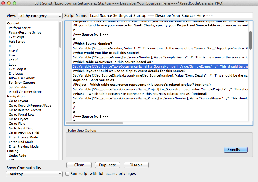

I think the issue is that your events Table Occurrence name is not SampleEvents, which is the default. If the TO name is something else, you need to adjust the script steps at the top of the script
Load Source Settings at Startup --- Describe Your Sources Here ---
to reference your TO name (see below). You will need to restart the file for this change to take effect.

I double checked once more and went to the "Load Source Settings Startup.." Script and also checked that against the drop down list of tables (on both versions I did). I also double-checked that the table that Source No 1 is using. I don't think that it the T.O. setting on that script line item. As I have redone the whole process as well.
