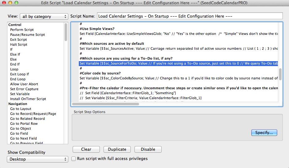

The idea is that you'll have a different table than source No 1 that contains these items. If you don't have a table already you can use the one we have in the stock file and import it into your file. In the stock file we have a different mini-window for to-dos, and you can use that one ore specify you're own. The layout and table that's used is specified in the script:
Load Source Settings at Startup --- Describe Your Sources Here ---

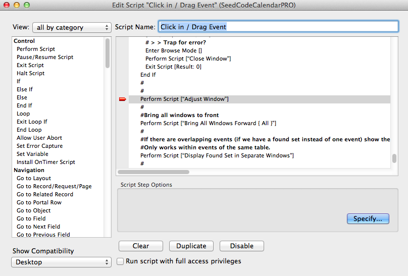

Don Penhailegon wrote:Yes, I am using the stock todo layouts but the todo detail layout wants to open to a full screen and not a mini window which would be more appropriate for the layout size.
We're calling our "Adjust Window" near the end of the routine which should resize it properly, so make sure that's happening.

Don Penhailegon wrote:I have input a todo and it shows on the due date only when I go to month view. Is this the normal behavior or should it input on the day it was created and then roll forward to the due date or untill the date it is done?
If the Due Date is later than today, then it should show up on that date. if it's in the past and hasn't been marked as done, then it should show up today. Once it's marked as done, then it should show up on the Day it was marked as done. We do specify if a source should have this to-do behavior in the start up script by source number, so I would check that setting to make sure it's specified properly.

Adjust window is in place and enabled. I understand now that you have to be on a ToDo List to create a ToDo item and then it will open in an appropriate window.
That should set it to the Layout Edges, so not sure why it would be staying big. Might need to step through that part with the debugger to see what's happening.

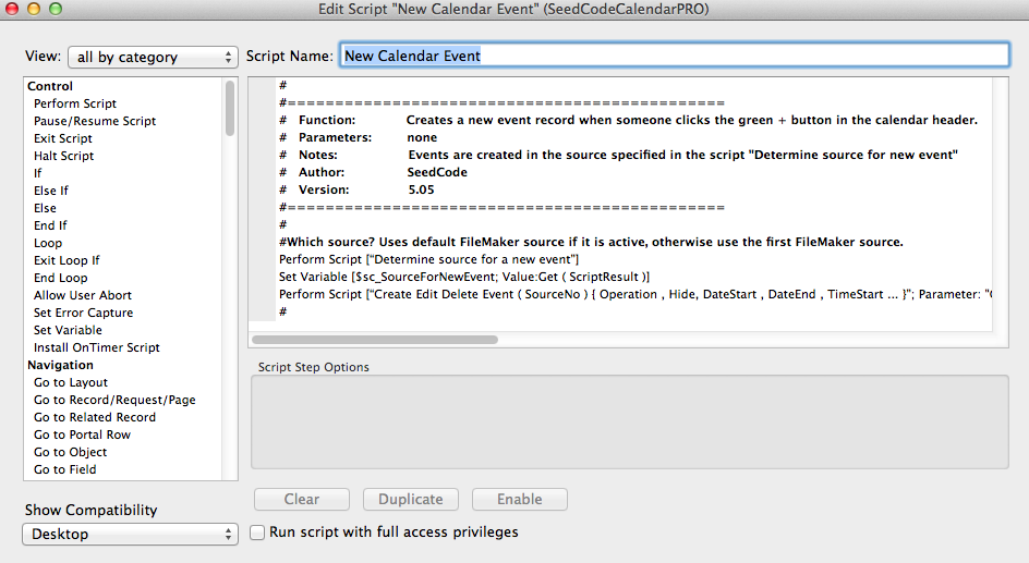

Don Penhailegon wrote:I think I would prefer to create a ToDo item from the focus of the Calendar than from the ToDo List
Perhaps I can duplicate the new ToDo button on the Calendar layout or would that not recognize the source number?
Right, if you only have the To-Do source selected than it will create the event for that source, but if you have both selected than it goes to the one you define as the default in the start-up settings script. By default, that's Source No 1. The New Calendar Event script runs a sub routine at the beginning to determine which source to use, so it would be pretty easy to use a parameter to bypass that and just set the Source to what you want.
New Event.png (111.3 KiB) Viewed 23401 times
Let me know if that helps!
