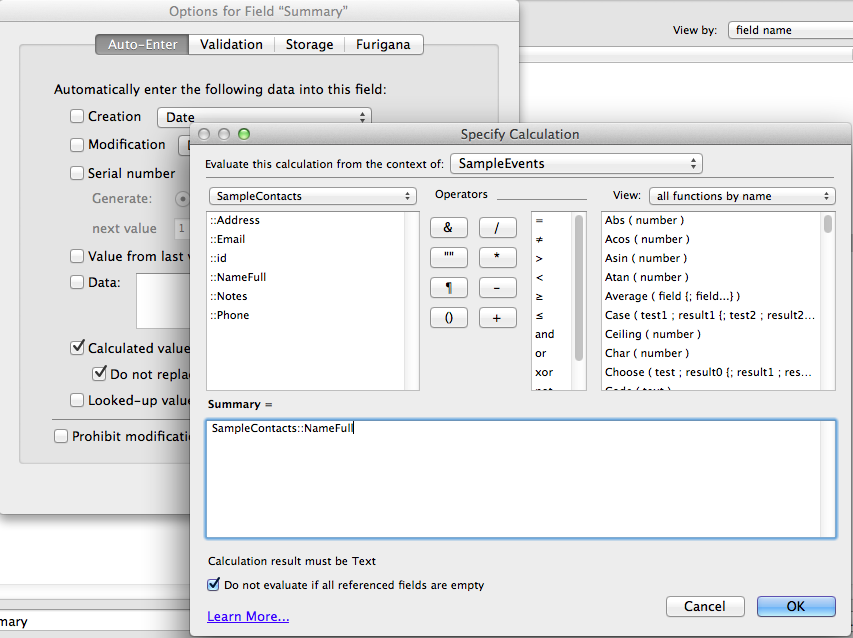

Once you've selected the id_Contact with the drop-down then the relationship is established and you can use any data in the contact table. Probably the easiest thing to do would be to set your summary field as an auto-enter calculated value that references the company name like this (only using your contacts table):
Screen Shot 2012-11-05 at 10.19.02 AM.png (123.39 KiB) Viewed 4260 times
This will fill in the value for summary with the company name as soon as the relationship is established.
