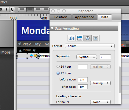

My actual issue lies with the grey "time" column on the 'Calendar' layout as this still shows times in the 12hr format. Can I modify this and how would I do that?

The display format for fields needs to be done at the layout level. So you'll need to go into layout mode, select the field (unlock it) and then use the inspector to change the field time format from 12 to 24 hours.
Screen Shot 2012-11-05 at 10.22.29 AM.png (67.97 KiB) Viewed 4896 times

PostPosted: Mon Nov 05, 2012 10:11 am
Excellent, thanks Jason...
