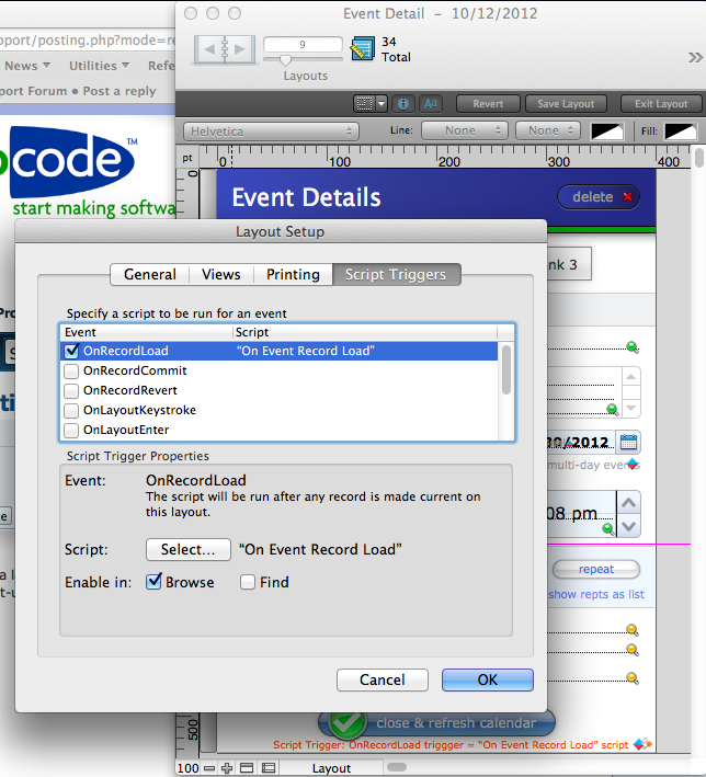

There should be a layout based script trigger on the Event Detail layout that should handle this (On Event Record Load : OnRecordLoad), so I would check if that's set-up and nothing is broken in the script itself.

PostPosted: Fri Oct 12, 2012 8:10 am
Thanks, Jason. The script is OK and nothing is broken, but the problem persists

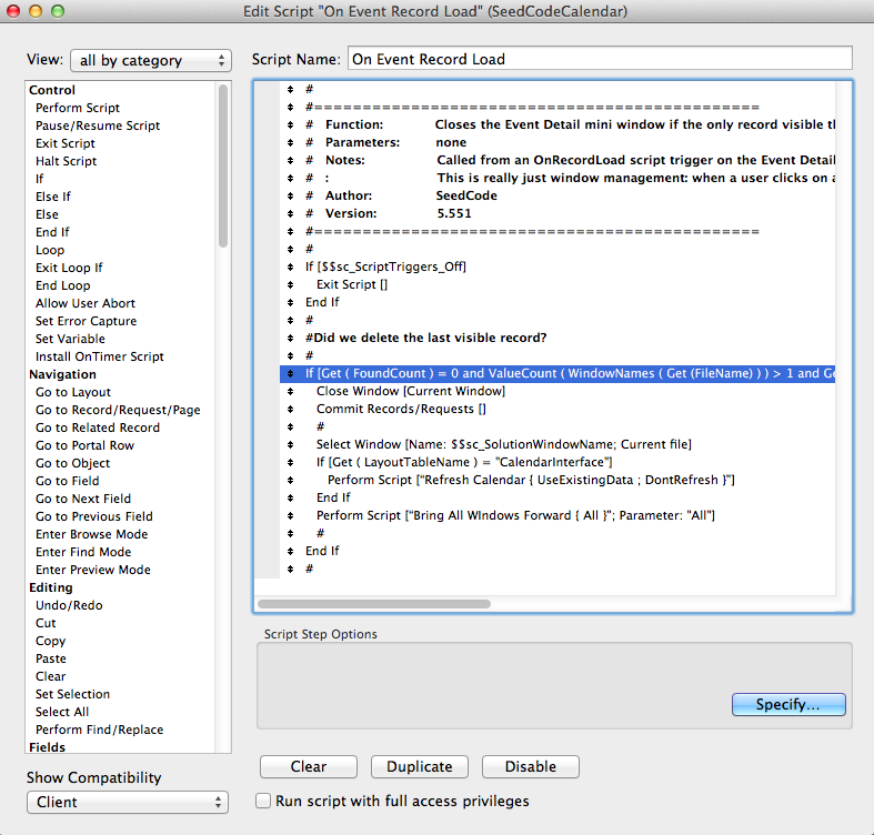

Not sure why it's not working. When you open the window form the calendar, there should just be one record in the found set, so when you close the window this should be true
IF [Get ( FoundCount ) = 0 and ValueCount ( WindowNames ( Get (FileName ) ) ) > 1 and Get ( TotalRecordCount ) > 0]
and run the part of the script that closes the window and runs the refresh. The thing I can think of is that if you only have one event and are deleting the last one, then that part won't run.
If you have Advanced, can you check this script with the debugger to see what's not happening?

Hi, the script is OK, I checked it with the debugger and there is no problem, but the problem persists:
when I delete an event clicking on the "Delete" button in EventsDetails layout, all the data are deleted, but the window doesn't close and the summary is displayed on the calendar.
