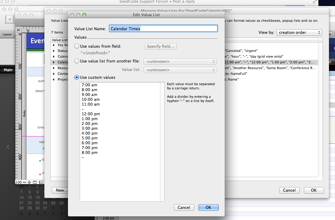

Thanks for the screen shots. That's a stock FileMaker error when there's a conflict with the system or file formatting of the file and the data entry.
I think all you'll need to do is to change the value lists that we use that has this format: hh:mm:ss to the dot format that your file is set to: hh.mm.ss so that when you select a time you don't get the format conflict error.
PostPosted: Fri Sep 28, 2012 10:27 am
Here's a screen shot of the value list to edit:
