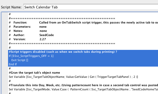

Hi, i'm trying to use the print feature in the calendar layout but it always switch to the day view; there is no way to print the week or month tab? how can i fix it?

Excellent catch on the printing! While I love our OnTabSwitch script triggers, they were getting the better of us here. To fix this, please add the lines in blue (below) to the script "Switch Calendar Tab".

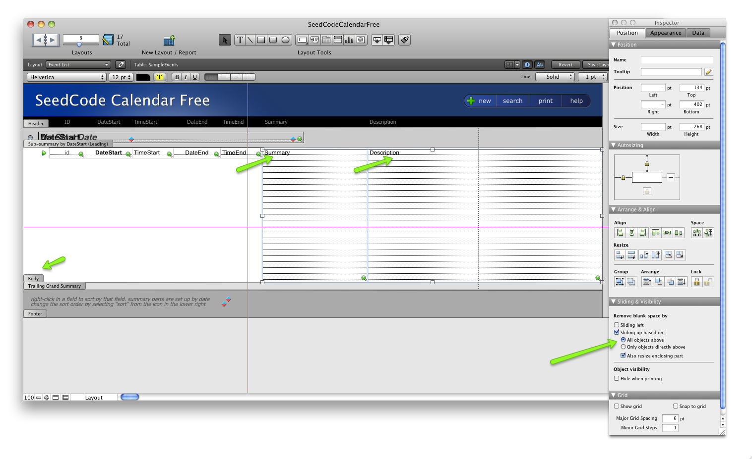

When it comes to seeing all the info for an event, you're better of printing a list of events instead of one of the calendar's views, we just don't have enough space to display all the text for an event. You may want to duplicate the event list layout and make the body taller (turning sliding on) so you have bigger possible area to print.

Fixed!! Many thanks John!

2. If you want to see more of each event when you print you'll need to print our Event List view instead of the Day, Week or Month views. List view is the only place where you can make the body part / description taller and then set them to "side up" on the position tab of the inspector. Again, you may want to do this to a duplicate of the list layout just for printing. That way you can change the field borders, etc to be just the way you want your print out to look.
Oh, and you'll want to pint this list manually, or modify the print scripts to use this layout when you're on it. And remember that the list view won't automatically "keep up" with the week and month views so you'll need to build the found set to be printed by hand, or write scripts to find just the events you want to print.
