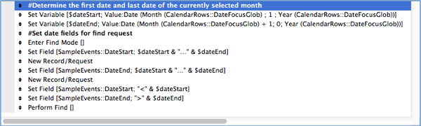

I might have been over complicating things here. To cover all scenarios with dates we will basically need 3 find requests. One that checks if a start date is in a given month. So in your start date field you would find "8/1/2012...8/31/2012". Then another find request for the end date. So in your end date field you would put the same thing "8/1/2012...8/31/2012". Then a third that would check for before the first start date and after the end date. So in the start date field you would find "<8/1/2012" and in your end date field ">8/31/2012".
Check out the attached screenshot for a very simple version of this script. Let me know if it is unclear.
Tanner

I've just tried the script but doesn't work correctly.
Instead I found a simple way (perhaps rather rudimentary) that works perfectly:
In Source no1 layout I've created a calculation field that shows the year and the months of the event. For example if the month of start date is June and the final month is August, I can see: June, July, August and the year.
I've created a new script modifying the "Write Filmekaker Source to Variable" script.
To print an event monthly list, first I set a local variable with the month name and the year. I set the new field with the variable and perform find.
Then I'm going to my event list and I can print.
Thank you very much for your help!!
