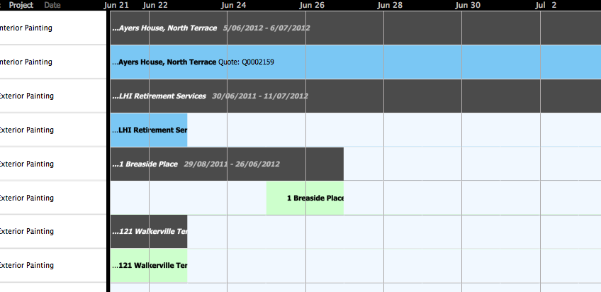

on the Gantt
the requirement is for the collapsed view to show the second row of the expanded view only
In other words after open all, the first dark grey row of each row pair is to be deleted, so that only the conditionally coloured ( on status) lower row of each row pair shows
How?

Hi, thanks for responding
the requirement is one row per project only. as per the collapsed all state, but with the rows:
- colour coded for the quote status
- with customised text ( quote title and quote No
- sorted by the quote status: begun (blue), waiting (green)
have the colour, text and sort happening , but can't get rid of the grey row
So in the attached pic, hide the grey rows, and only show the blue and green rows.

I can't see what's going on with the arrows to the left of this screen-shot, so am still not sure I'm following you.
The grey bar represents the whole length of the project defined by the related events so if you get rid of that, then you won't be able to expand and collapse the events by project. Also the events below will only show their duration rather than the length of the project.

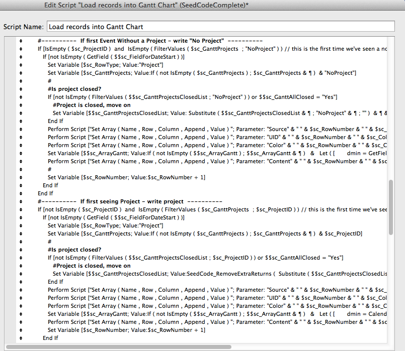

I think an easier approach might be to keep the Project line, but try to change it's color and content. We "draw" that line in the script Load Records into Gantt Chart. The lines that draw the color and content could be altered here to get the results you're after, i.e. "Color" and "Content."
You could also experiment with just disabling the whole block so the project line doesn't get drawn, but again then there won't be a way to collapse it.

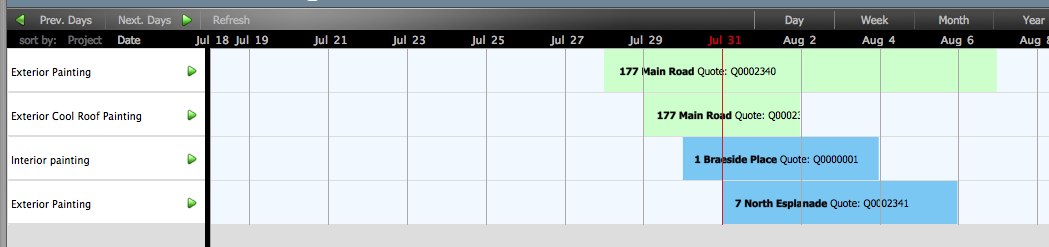

PostPosted: Tue Jul 31, 2012 5:53 am
in the end , for reasons totally arcane, the sort by date button returns the required display
Screen Shot 2012-07-31 at 11.19.51 PM.png (43.85 KiB) Viewed 19489 times
PostPosted: Tue Jul 31, 2012 5:59 am
Of course! Can't believe we didn't think of that... sorting by date omits the project / phase hierarchy and just shows events. Congrats.
