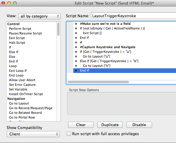

Next question: Is it possible to create keyboard shortcuts for navigating from one layout view to another?
-BW
PostPosted: Mon Jul 09, 2012 11:32 am
Great!
Yes, you should be able to put something like this together with a layout based OnLayoutKeystroke trigger something like this:
probably need to experiment with that a bit, but that should get you started.
