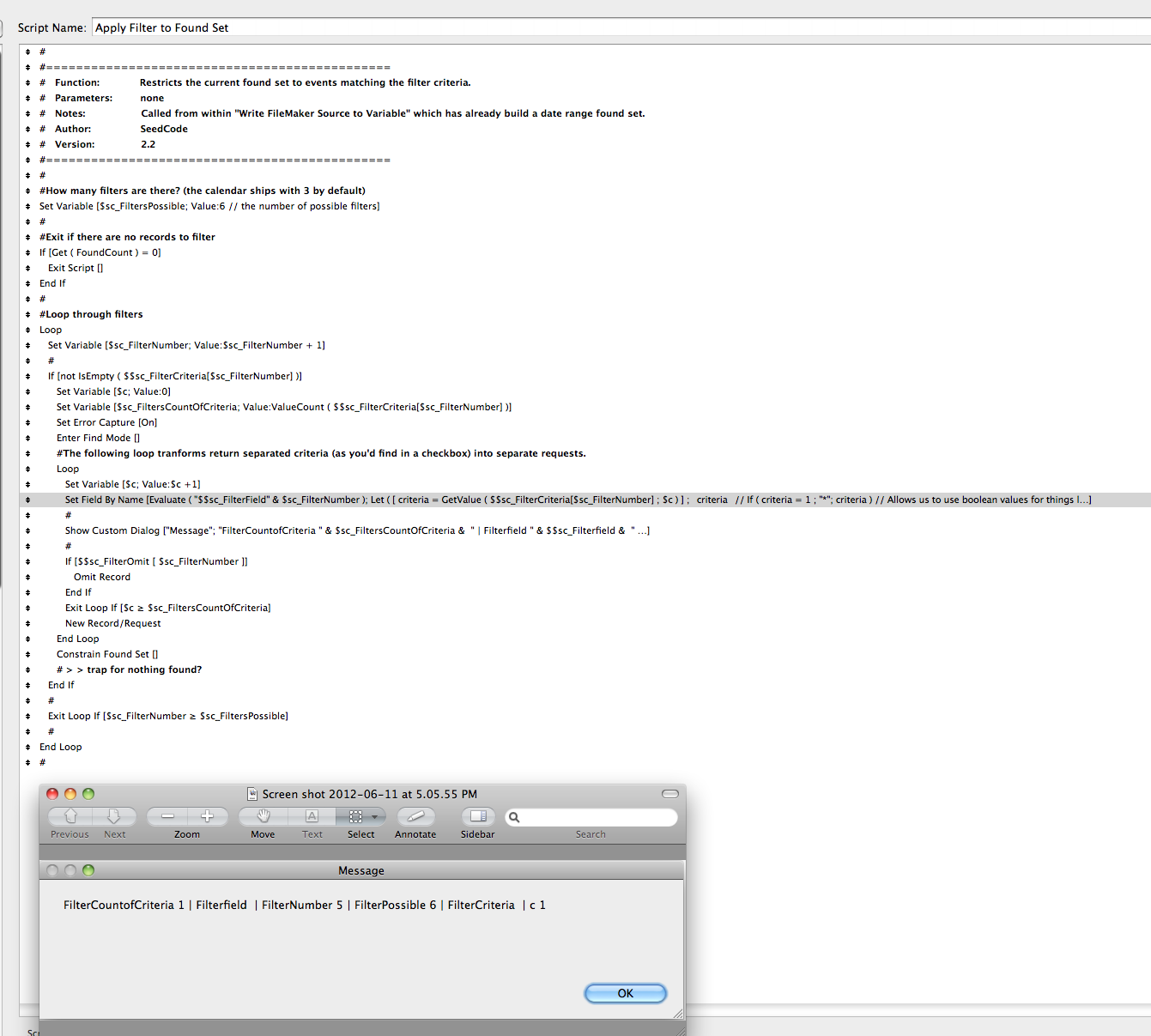

I have added a message to show me what the values of all the variables are and it seems it is not setting the value for FilterField and also not for FilterCriteria. I have attached a screen shot of my script and the message. The message comes up only once when I try to filter by staff.
It seems that something is wrong in the highlighted line.
Does this help you identifying the problem?
Thanking you in advance.

PostPosted: Mon Jun 11, 2012 8:30 am
Right, it look alike there's no field or criteria being set for that iteration, but I can't tell why from here.
The things to check are that you have the filter filed and number specified correctly in the:
Load Calendar Settings - On Startup --- Edit Configuration Here ---
script and that you have the OnObjectSave script trigger on the filter field set to Filter Calendar ( Number ) with a parameter of 5.
Other than that I'll need to take a peek at the file, which I'm happy to do.
Let me know,
PostPosted: Mon Jun 11, 2012 10:30 pm
Hi Jason
I got it! It was wrongly set in the "Load Settings - on Startup" script. I did make a change to this some time ago and didn't realize, that it will affect the filters in the calendar.
Thanks a lot of pointing me in the right direction.
