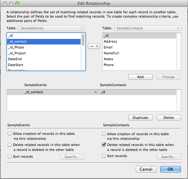

The quick integration Works fine! Now I have a doubt. My Contact file now is attached to the calendar. I would like to know what happen if the user delete a record on the calendar it will be deleted on my contact program? If yes how to prohibit the user to delete a record only on the contact management program when it have to be remove from the calendar?
Again thanks
PostPosted: Tue May 15, 2012 7:11 am
Related records are only deleted if you set that up in the relationship, and by default it should be off. Here's what it looks like if deleting the event would delete the Contact, so you'll want to make sure the checkbox is not checked.
So, if I'm understanding you correctly, you won't need to worry about the contact getting deleted unless you have the above box checked.
