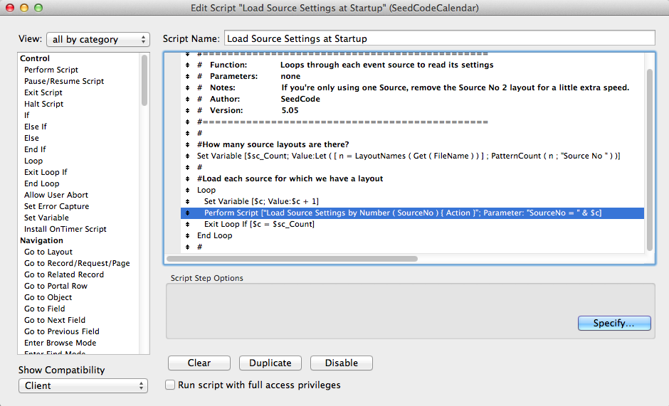

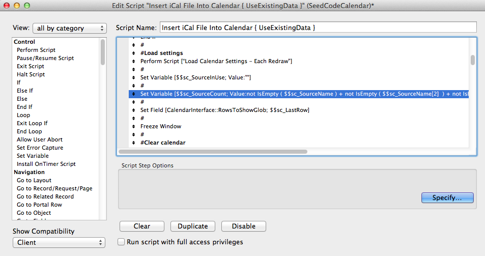

That variable itself gets set in the script: Insert iCal File Into Calendar { Use Existing Data } which is part of the main calendar refreshing routine. It counts the different $$sc_SourceName[] variables which are set at start-up. Here's some shots of the scripts in play.
Source Count.png (95.39 KiB) Viewed 5621 times
Source Name.png (99.34 KiB) Viewed 5621 times
