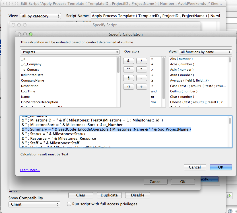

The first when using the "add milestones from template" button - every event created has ProjectName appended to the actual event summary, which is creating mass clutter on both the Project Details view and the calendars.
It's a pretty easy change once you find it. In the script:
Apply Process Template ( TemplateID , ProjectID , ProjectName ) { Number , AvoidWeekends }
It calls the script:
Create Edit Delete Event ( SourceNo ) { Operation , Hide, DateStart , DateEnd , TimeStart ... }
with a somewhat complicated calculation for the parameter. It's in there that we're appending the milestone name with the Project name. The highlighted line below shows where this is, so you can just remove the: & " " & $sc_ProjectName to keep that from happening.
It's also making the event summaries all lowercase, instead of Capitalized (or unchanged) as I have it in the template. Is there an easy way to correct this behavior?
Yes, the custom functions SeedCode_EncodeOperators and SeedCode_DecodeOperators use the "Lower" function. You can remove that part of the calculations so they looks like this:
The second is on the calendars - ProjectName again is showing up causing all manner of clutter, this time prepended. This isn't done as part of the event record, so I'm guessing it's somewhere in the Calendar layout. Same question for this one.
This will probably be helped from changing the way it appends above, but the field in the events table called: z_AlternateSummaryCalc is what determines what is displayed on the calendar by default, and Project name is part of its makeup. So, you can adjust that calculation in the Data file, or you can map the calendar "summary" to a different field on the Source No 1 layout.

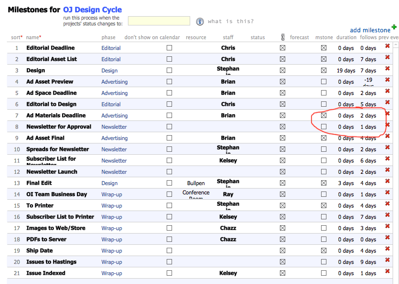

No problem, this first view shows 2 events in the project template (circled). Newsletter for Approval has a "follows" of 1 day:

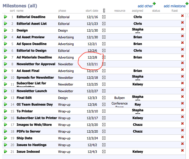

This second view shows the resulting schedule after the template has been applied. Note that there is a 3 day gap between "Ad Materials Deadline" and "Newsletter for Approval" circled in red.
Project View
This 3 day gap happens no matter what start date I give the project. If I set the "follows" to 2 days I still get a 3 day gap. If I set it to 0 or less (negative), or 3 or more days, it works exactly as it should. It almost seems like it's picking up a ">=3" somewhere on the positive end (I'm very new to FileMaker, hopefully that made sense).
I have the event durations set to 0 for most of the items, as that made the behavior a bit more predictable (it only acts weird with 2 items now).

PostPosted: Wed Mar 07, 2012 10:05 am
Hi Chazz,
Thanks for the screen shots. They are a big help.
I think what you're seeing here is the "avoid weekends" behavior. You can toggle that off in settings: try that and let me know what you see.
Posts: 7
Joined: Fri Jan 20, 2012 12:05 pm
Location: Prescott, Arizona
PostPosted: Wed Mar 07, 2012 10:20 am
Yep, that was it... which explains why it worked fine for the first week. I'll keep that setting disabled.
