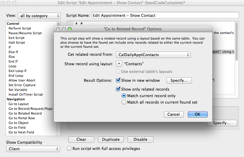

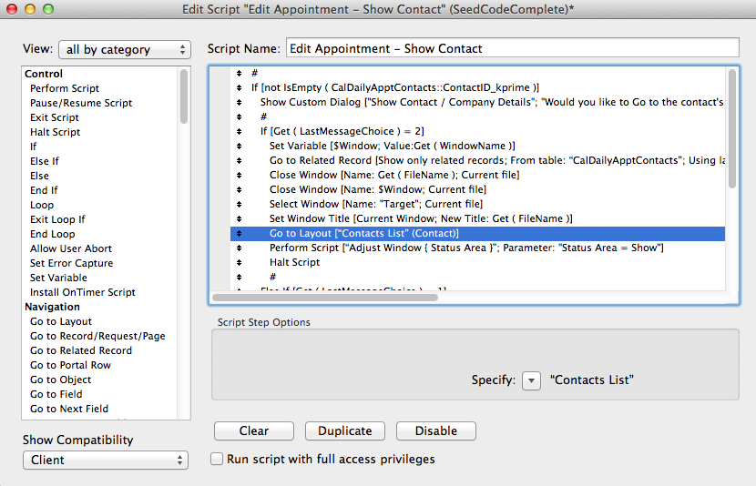

You don't need a new TO. You can do a Go To Related Records from the event to CalDailyApptContacts.
The script: Edit Appointment - Show Contact should work for this, you can just (duplicate and) modify the script so that the GTRR only shows related records and that you land on Contacts List.
