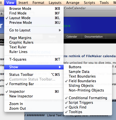

Listen, I've been trying to change the text on some buttons such as "new event+" and not been successful as well as the text on "click to select an existing company" and so on. How do you do that?

PostPosted: Mon Jan 30, 2012 10:17 am
Some of these might be groups of objects arranged together, and sometimes it's not that obvious which is which. Turning the different "Show" settings on and off can be helpful with this:

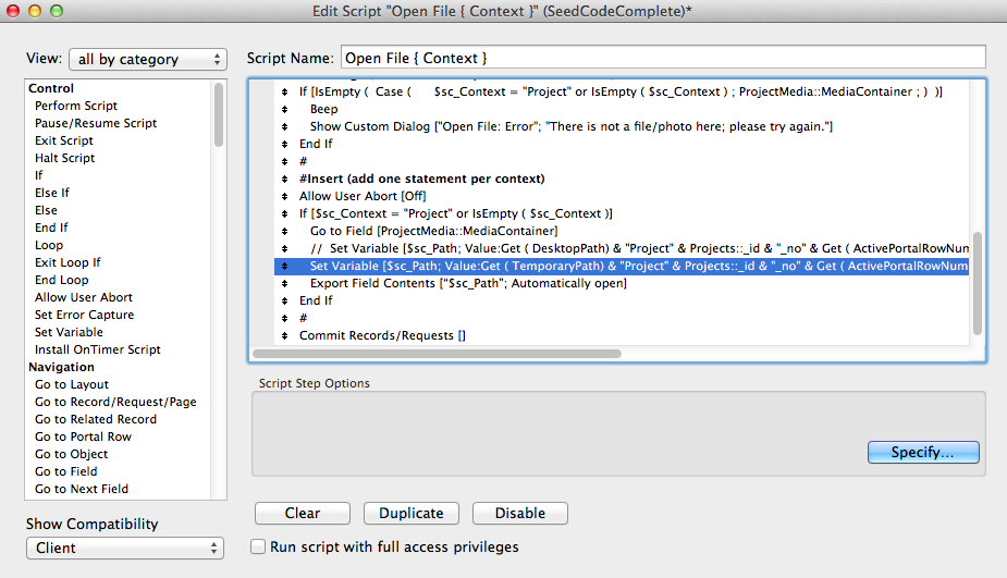

I do not know if you have noticed but under Projects/Files & Photos there's a link called "open file" and when user click on it to open file it creates a temporary file but when file/photo is removed from DB the temporary file is not removed. Is there a Delete File script available?
Thanks.
PostPosted: Mon Feb 06, 2012 7:28 am
I think I got it. We're using FileMaker's straight "Export Field Contents" to the desktop with the setting to automatically open the file, so by default the File just stays on your desktop.
I remember hearing a "trick" where you can delete an exported file, by exporting to the same path, but referencing an extra container.
The easier thing to do is probably to modify the "Open File" routine to use the "Temp" folder rather than the desktop. This is hidden and cleans itself up when the FileMaker session ends, and you don't need to mess with deleting an external file. The change is easy, as there's just one script step to update.

PostPosted: Mon Feb 06, 2012 7:30 am
Whoops! Not sure that's inline. Here's the screen shot of the script again:

Joined: Tue Dec 20, 2011 11:29 am
PostPosted: Mon Feb 06, 2012 8:55 am
Jason,
Thanks a lot, it worked. When exiting, FileMaker removes the temporary files from the temporary folders.

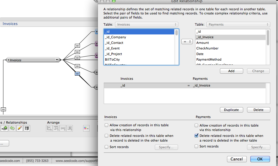

PostPosted: Thu May 10, 2012 1:17 pm
Hope all is well. Right, we call that a "Cascading Delete" in FileMaker and we don't have that set up for payments by default, but it's an easy change. Cascading deletes are set up in the relation graph and the one for Invoices and Payments is here, you'll just want to click that checkbox:
