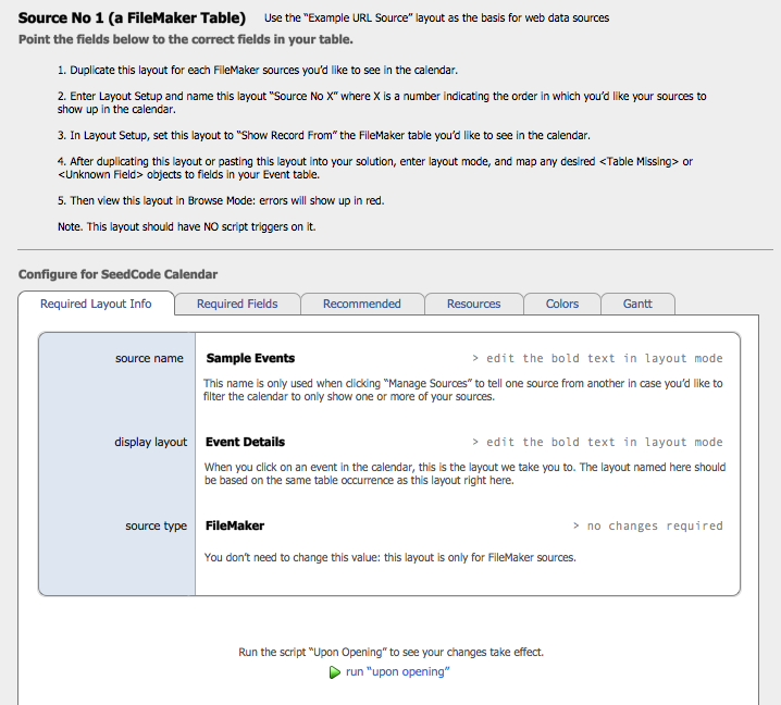

Hi Kevin,
On the layout for your additional FileMaker Source, you need to specify which layout is used for the "Event Detail." For Source No 1, we've specified the "Event Details" and the script uses that text to determine where to land.
Source Set Up.png (108.73 KiB) Viewed 25495 times
This happens in the script "Load Source Settings by Number ( SourceNo ) { Action }" which is called by the script "Click in / Drag Event." I mentioned in the previous post.

I have confirmed that both the Source No 2 layout is based on Transparency (Source 2) and that the layout details for Transparency is also based on that table. Still no luck. If I make the only active source Transparency, it still creates a new record in Appointments. If I change the script Determine Source for New Event to simply exit script with result 2, it STILL doesn't create the new event in table Transparency (Source No 2). At the moment, it is not defaulting creation to Source No 2 if Source 1 is inactive, even though the Script Determine Source... is clearly choosing the second source is Source 1 is inactive.

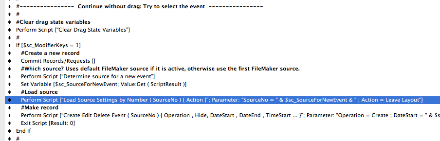

Thanks so much for your time, I still am unable to work this out. I pasted in the updated script to Determine Source for new event, with no luck. I can even set this script to exit with result 2, and it will STILL create the new event for source 1. Something else must be amiss...

PostPosted: Fri Jan 06, 2012 1:03 pm
Hi Kevin,
Ok, two things. I think there's still an issue with the Case Statement. As once it realizes the active source is not the default it just goes down the list without checking for active first, so that's why "Determine source for a new event" is still returning a 1. After further review it should look like this:

That should correct that script, but it sounds like you did a manual bypass on that and are still seeing issues, but hopefully the above will resolve it. The process is to call the script "Create Edit Delete Event" after determining the correct source and passing the source number as a parameter: see below:
