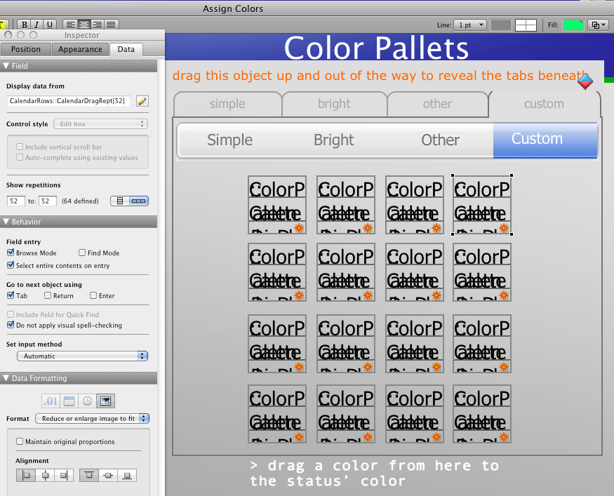

I'd like to add a 4th palette tab on the Assign Colors layout.
I've increased the field reps from 48 to 64 for both of the relevant fields, and have added a 4th block of RGB values to the field where those are stored.
Everything appears as though it should work fine, but after extensive attempts, no matter what I try, I can't actually drag and drop a color from any of the 16 fields on my 4th tab (named "Custom" in this example.)
To clarify, when I click and hold on a color blotch in my "Custom" 4th palette tab, it doesn't allow me to drag anything out of it -- no "drag ghost box" appears, as it does (and should) in the other three palette tabs.
I must be missing something simple as I don't see any complex script interactions here.
Here's a screen-shot to clarify what I'm trying to do:
Assign Colors layout, w/ custom 4th palette
Screen shot 2011-10-25 at 10.28.59 PM.png (189.02 KiB) Viewed 11994 times
By the way -- the word "Palette" is misspelled in the Assign Colors title, FYI. (Bug-fix points?)

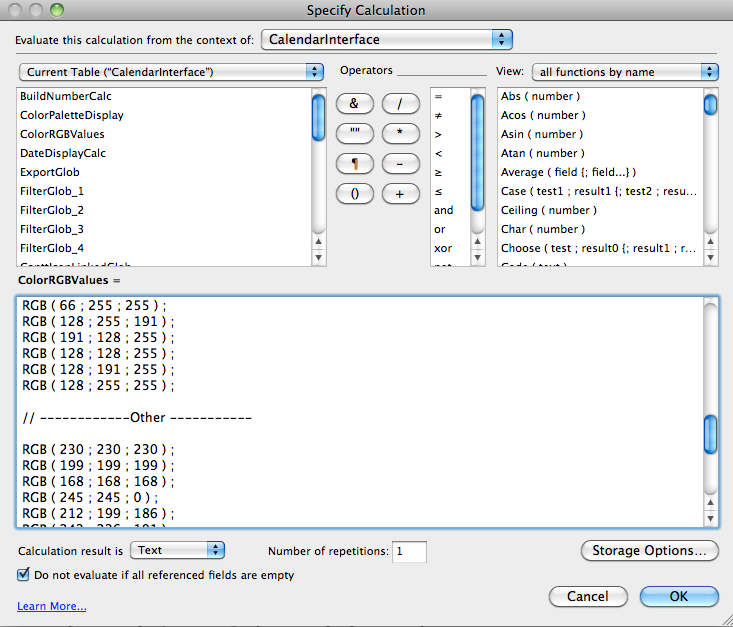

So there's a bit more going on here than meets the eye 8)
You'll also need to add the corresponding RGB values into the field CalendarInterface::ColorRGBValues :
That's where they're actually getting pulled from. The repetition number should match the value number here. It should work then.
This is a little more "under the hood" then most folks go, we "thought" 48 would be enough :wink:

Hmm,
I had (already) added a 4th block of RGB values to the field you specified, and indeed the new colors do appear as expected in my 4th tab.
I simply can't actually "drag & drop" the colors. My cursor enters the fields, and a highlight box appears, but I can't *move* that highlight box (by dragging it) across the screen.

PostPosted: Thu Oct 27, 2011 6:33 am
Hi Sam,
The field on top, CalendarDragRept,looks empty, but has a "space" in it; sounds like you're missing this value in the additional repetitions you created. I'd add these repts to a blank layout somewhere--instances where the repts have no script triggers on them--and paste in the contents of one of the earlier (<48) repetitions.
OR, edit the script "Create Calendar Records" and change the variable "$sc_NumberOfRepts" to 64, then delete all your CalendarRow records and run that script.
Either should get your drag and drop working.

PostPosted: Sat Oct 29, 2011 9:55 am
Ah, yes, that makes sense. I did that and now it works as expected. Thank you.
