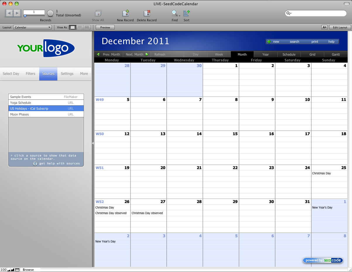

I'm a brand-new SC Calendar Pro owner / user; forgive me if I'm overlooking something obvious, here.
I set up a third Source, based on the 2nd sample source (an iCal URL.)
The Source works fine, except that it displays duplicates of every event, offset by one day into the future. The Source in this case is a US-Holidays calendar, so for example, Christmas shows up on 12/25 (as it should) but also shows up on 12/26. This happens consistently for every holiday:
Month-view calendar, showing the problem.
Screen shot 2011-10-24 at 1.40.39 PM.png (174.55 KiB) Viewed 12316 times

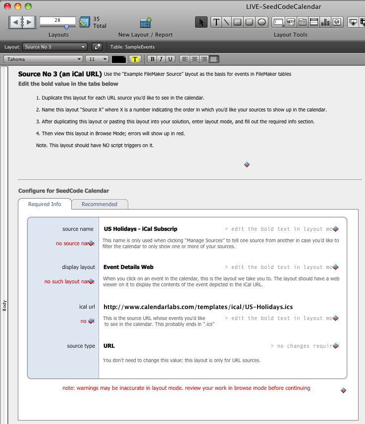

See attached screen shots that show my configuration, and the problem itself.
The Source #3 layout.
Screen shot 2011-10-24 at 1.39.31 PM.png (122.27 KiB) Viewed 12316 times

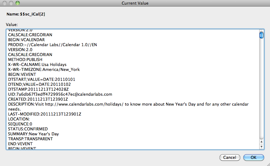

Right, we do our best to have these calendars follow the .ics rules, but there are exceptions to this. This calendar and (and other holiday ones) set a date range for these events, i.e. New Year's Day has a start day of the 1st and an end Date of the 2nd. Here you can see it in the ics string:
Calendar clients know that this means it ends on midnight of the first, but FileMaker is not so smart with midnight, so it reads this as a 2 day all day event, which is what you're seeing.

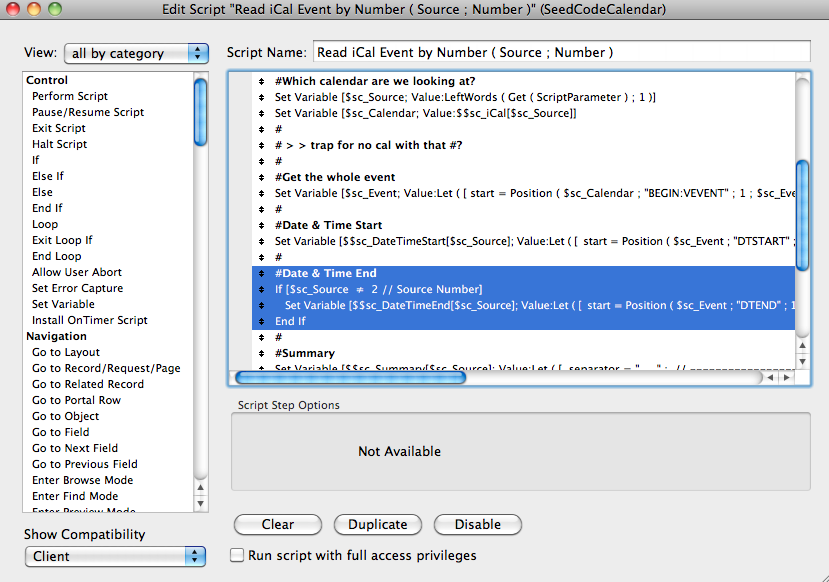

One solution is to teach FileMaker to ignore the end date fro certain source numbers. This can be done in the script "Read iCal Event By Number ( Source ; Number )." Here I've told the script to ignore the End Date for Source No 2, and that solves it in this case.

Thanks much for the concise and detailed explanation. I inserted the If... conditional you suggested, in the place you suggested, and the problem is resolved.
