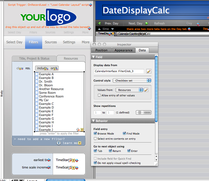

In CalendarInterface there is FilterGlob_3 and its comment is Orginally Resources, I was looking into using that field in the Sort FileMaker Records --- Edit Sort Orders Here script but it had no impact. What is FilterGlob_3's intended use?
And thanks again for the assistance.
PostPosted: Thu Aug 18, 2011 2:40 pm
That's a global field used in the filtering process, and as a Global, sorting by it won't do anything since it's the same for all records. I'd think you just want to sort by the field in the events table that references the Resource. In our Sample Events table this would just be the Resource field itself, but I'm not sure if you're using that table, or your own; but if it's your table, whatever the equivalent field is.
The filter Globs are the fields that show on the filter tab on the side bar, so you can see what you've selected. FilterGlob_3 is the one on the resources sub-tab:
