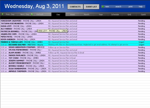

I have mapped out the z_AlternateSummaryCalc field to the summary field with the following parameters:
TextStyleAdd (CONTACTS_2::FULL_NAME ; Bold) &"-- "&Summary&"-- "&Resource
However, what I am seeing each time I am in the Day view of my calendar is a repetition of the "Description" of events from other dates (see screenshots attached).

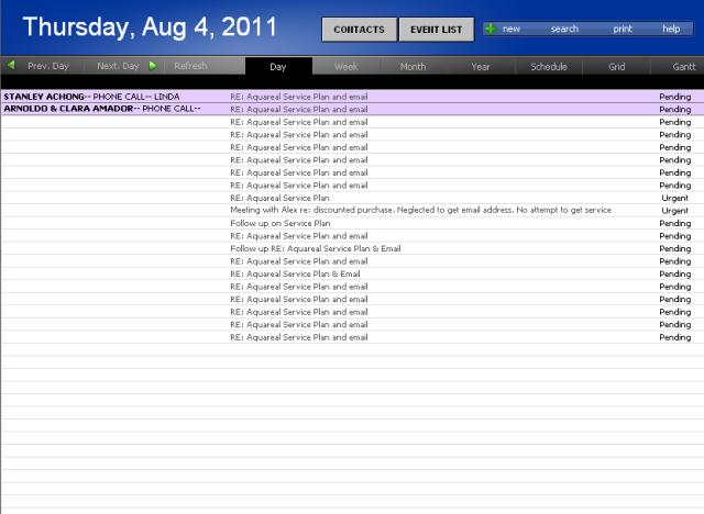

The .jpg titled Day_View shows an image of my calender with events scheduled for Wednesday August 3rd. The .jpg titled Day_View_2 shows an image of events from Thursday, August 4th - however, notice the descriptions that remain from the previous day.
More curious, my parameters are set to ~exclude~ the description field from the mapped summary field.
Any suggestions?
James

More developments on this bug. I also just discovered that the Event Description field data appears and disappears at random.
I have gone into the z_AlternateSummaryCalc field to double and triple check my calculation, and when I exit, the Description data disappears and I am left with the correct results of the calc. However, after navigating through different layouts on the calendar, the Event Description data randomly appears again...

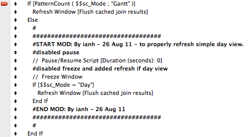

Change the Refresh Window step at the end of the "Refresh Calendar..." script to use the Fluch Cached Join Results option. If you're on a Mac you can leave it like this but if you're on windows or want the best possible performance you can wrap it in an If statement so it uses the Flush option only when $$sc_Mode = "Day Sched" and uses a regular refresh elsewhere.

Many thanks, John for pointing in the right direction so promptly. Now sorted I think.
Turns out there was no Refresh Window unless for Gannt - but there was a zero Pause and a Freeze window. I disabled them and added a Refresh with cached join if in Day view. It works.
Also - I tested on Mac and Windows - looks like flush cached join results is needed on both platforms for it to work properly.
PLEASE let me know if there was some critical reason for having the Pause and Freeze Window steps. Maybe I was wrong to disable them?
Screenshot of Mod to script attached - maybe it will help someone (James_F)?...

Hi. The freeze/pause is a gentler way to refresh that doesn't cause flicker on Windows. But if you include "real" fields on the simple view (as we have with the status field) you need the flush that only refresh window/flush offers.
Congrats on getting this sorted.
