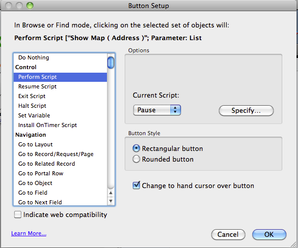

To change the parameter, double click on the button in layout mode and you should see this:

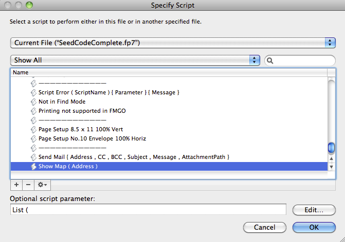

Then click on the Specify button to see this:
Then hit Edit... to bring up the following, where you can adjust the parameter to reference your Property Addresses rather than the Contacts ones:
That should do it, but let me know, we'll make a scripter out of you yet! :wink:
