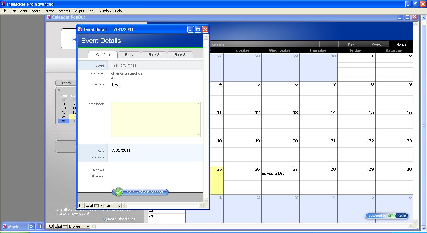

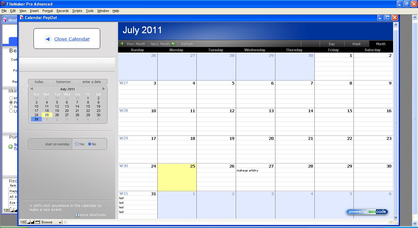

Thanks for the reply. I'm sorry I wasn't able to explain it right. Here are some screens to show you what I mean. Please see the attachment "Calendar.jpeg." Notice on the month view that on the 31st there are multiple items called "test." these were put on the calendar as a result of a script that inserts event items for each customer if they fit certain search criteria. So each line is for a different customer. However each line I click on shows the same row on the Event Detail layout that pops out for the item. See EventDetails.jpeg. Once the layout pops out, I can scroll through the related records and they're all there but no matter what row I click on in the 31st, it always goes to Christine Sanchez, the first row of the related set.
To make it go to the same row when it pops out the event details layout, I tried to change the Click in Event script to set a variable at the beginning with the recordnumber, then go to that same one when the layout pops out, but its like a click doesn't actually activate the row selected, since it appears to set the first record every time.
I would like it to go to the row number that I clicked in the month view of the calendar. My ignorance comes from the fact that I honestly don't understand how the calendar setup works basically, but I love how I was able to just snap it in.
Sorry again, I hope that explains it better. Thank you for showing patience with me.

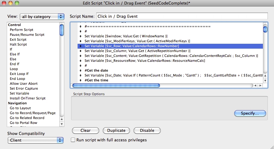

In the script Click in / Drag Event we use the variable $sc_Row (defined by CalendarRows::RowNumber )
and $sc_Column ( defined by Get ( ActiveRepetitionNumber ) ) to determine which "slot" you clicked in.

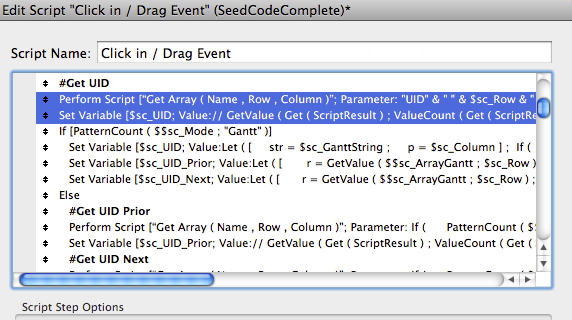

We then use the row and column to figure out the primary key/UID of the event:

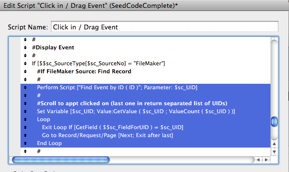

Once we have the id, we then use it to find and scroll to the event if there are overlaps:
It seems like it might be something with the ids (not unique maybe?)
