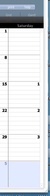

    1. Scroll bar is inactive, I see it but does not work.
    2. Scroll bar hides the Saturday date number.

Rightside view of scroll bar and date numbers

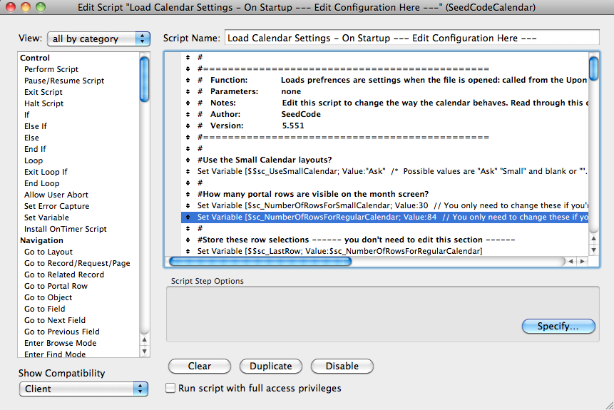

First, you do want to adjust the 36 rows to account for the additional rows per day. It should be rows per day * 6, so should be 84. You want to make that change here:
Load Calendar Settings - On Startup --- Edit Configuration Here ---

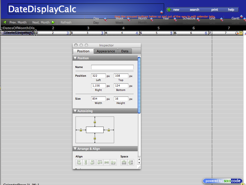

Second, adding the scroll bar cuts into the calendar body, so you want to reduce the length of each repeating calculation field to be "clear" of the scroll bar. I just did a quick check and 834 pixels seems good. If you select the repeating calc fields one a time on their far righy, and change them to 834 pixels in the inspector, you can "peel" each one back until their all at 834, and then it should look good.
Let me know if that helps.
