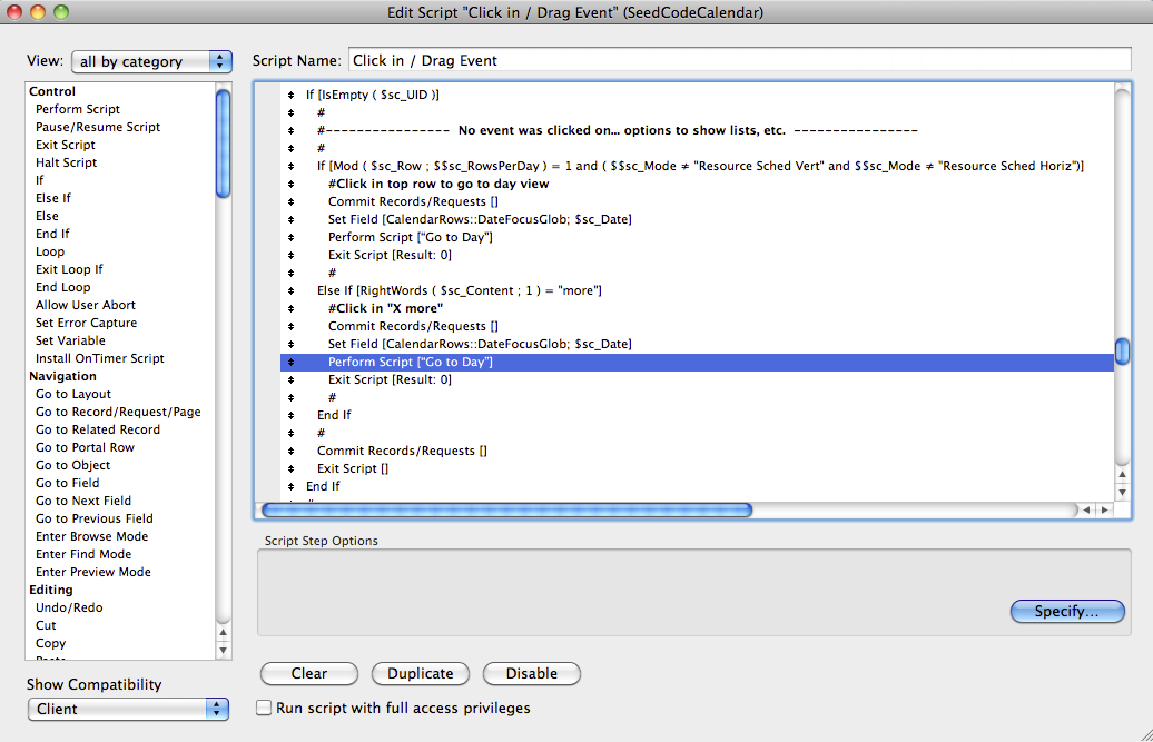

There seems to be a hidden button/script in the date (row one of the portal) on the Week tab that loads the clicked date into the Day tab. I'd like to change this so that when the date is clicked that date is loaded into the Schedule tab. Any pointers?
PostPosted: Wed Jul 20, 2011 7:19 am
Hi Max,
That's part of the script trigger that calls the script "Click in / Drag Event." I've attached an image of where the Go to Day script is called.

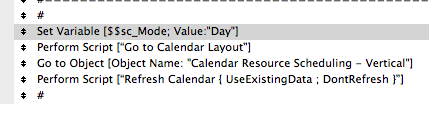

I'm surprised there isn't already a "Go to Schedule" script.
If I duplicate and modify the GO to Day script...
Picture 4.png (19.12 KiB) Viewed 6333 times
What should I have the $$sc_Mode variable be? I tried every thing from Schedule to even the Tab's name, but no luck so far.
PostPosted: Wed Jul 20, 2011 2:44 pm
Hi Max,
Go To Day is specific to drilling down from one of the other views. If you want to go the the schedule, then I would do the equivalent of hitting the schedule button:
Go to Calendar Tab ( Tab Name ) with a parameter of "Calendar Resource Scheduling - Vertical"

Thanks Jason.
And for completeness, it the first "Go To Day" in that section that needs to be changed.
