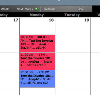

I'm working on a mod to have multiple lines displayed in the simple view for the Week layout, but running into a few issues and looking for the best fix... I'd like to avoid having a portal inside a portal.

This is the modified simple week view were multiple lines are displayed:
Week multi line.png (36.89 KiB) Viewed 10055 times
The issue becomes the dead space due to "line one" being used for the week/day number. Obviously I would not want to get rid of week/day numbers, but the way things look my solution would be to have a "one line" portal for the week/day number, then a separate multi line portal (with repeat) for the event data. Any other thoughts on how to do this?
I'd also want to lose the ... and have line breaks. I seem to remember those are in a script somewhere.
Which script do I need to dig into to have simple day show ... while simple week uses line breaks? (like in the non-simple view)
As always thanks for the support.
PostPosted: Tue Jul 19, 2011 6:33 am
Hi Max,
You can specify the starting row of a portal, so you could actually have two portals here. One on top that's one row and one line for the day numbers, and then another two line portal right below it that starts on row 2.
DPmax wrote:I'd also want to lose the ... and have line breaks. I seem to remember those are in a script somewhere.
Right, that script is: Read iCal Event by Number ( Source ; Number ) where the summary is assigned.
