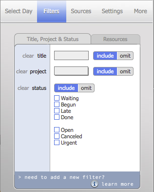

PostPosted: Mon Jul 11, 2011 6:29 am
Hi Sohala,
I might not be understanding correctly, so let me know. The pre-filters are static by their nature as they're basically default settings before any of the dynamic filtering is done. The regular filtering fro the calendar is dynamic. We have selectors set up for event name, project name, status and resources. Adding one for staff/names would be easy, and many people convert the resources selector to staff/names.
Screen shot 2011-07-11 at 8.24.51 AM.png (33.89 KiB) Viewed 5413 times
Let me know if I'm close,
