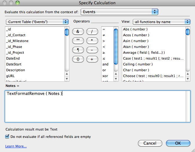

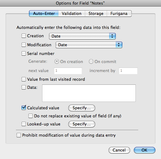

Thanks for the post. This is a pretty common issue. The best way to deal with this is to make the field they are pasting into an auto-enter calculation that is set to replace existing contents. You can then use the TextFormatRemove ( text) function on itself.
For example, if the field is named Notes. The calculation would look like:
TextFormatRemove ( Notes )
I've attached a few images as well.
Screen shot 2011-06-30 at 10.14.24 AM.png (67.99 KiB) Viewed 7826 times
Screen shot 2011-06-30 at 10.14.49 AM.png (79.14 KiB) Viewed 7826 times
