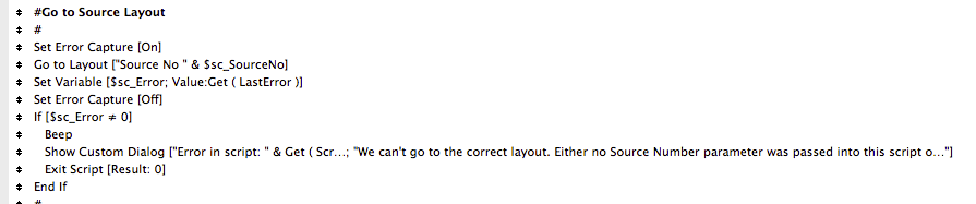

On a separate point, I am getting the error
"We cant go to the correct layout. Either no source number parameter was passed into the script or there is no source X layout where x is the source number. "
There is a "Source No 4" layout. What am I doing wrong?

The error your seeing is coming from the subscript:
Load Source Settings by Number ( SourceNo ) { Action }
If you have FileMaker Advanced, then stepping through with the debugger would be the best approach. My suspicion is that the parameters aren't being passed correctly and the variable $sc_SourrceNo is not getting populated correctly. We just calculate the layout name from the parameter and then try to go to the layout by name. If we can't find the layout, then we throw that error.

Hi Jason
I deleted the problem source and redid it from scratch and it worked OK - thanks for the pointer.
