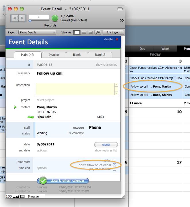

I have changed the settings for quite a lot of Events to "don't show on Calendar" however, the items are still all showing on the calendar?
As you say in your documentation its self-explanatory, but its not doing what I thought it will do.
I have attached a screen shot. Am I getting this wrong or do I need to make any changes to settings anywhere else?
Screen shot 2011-05-30 at 3.55.52 PM.png (157.9 KiB) Viewed 10511 times

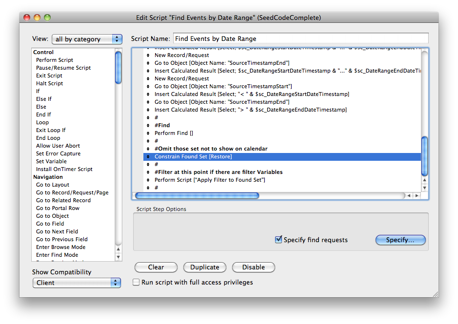

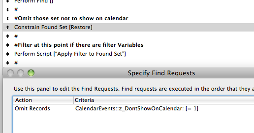

I think we may have missed the step that actually omits these in some builds. In the script "Find Events by Date Range" you should find a comment toward the end that says "Omit those set not to show on calendar". The following step should perform a constrain found set command, omitting where....
CalendarEvents::z_DontShowOnCalendar equals 1
...like the screen shot below.
Sorry for the inconvenience!

The step was missing completely in my script, however if I add it, it still doesn't work.

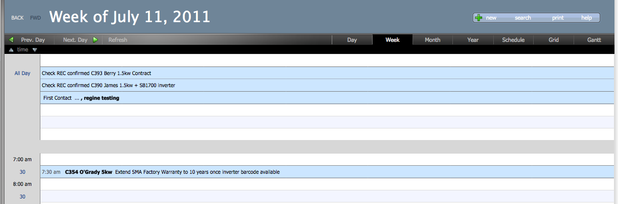

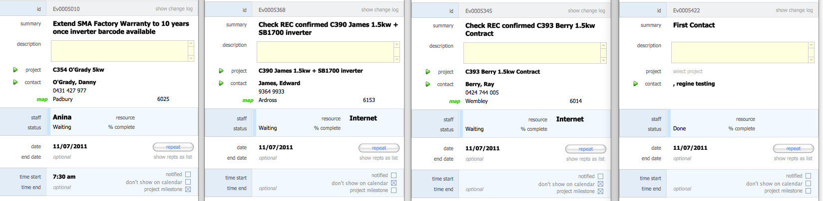

Attached a screen shot of the script step I added as well as some events (2 events with tick, 2 without ticks) and the calendar view after pressing Refresh.
It still shows all events regardless of the tick in "don't show on calendar".
If I change the Action to "Find" instead of "Omit" all events disappear from the calendar.
I can't make any sense out of it.
Any idea why it is not working or what else I need to change?

PostPosted: Mon Jul 11, 2011 6:18 am
I think the way you have the find set up is not quite right. You don't need the equal sign with a number, so you can just put a "1" rather than "= 1"
We use the "=" when we're trying to match a whole word, and in that case you want to make sure there's no space between the "=" and the value you're searching for. "=1" should work(no space), but is no better than "1"
PostPosted: Tue Jul 12, 2011 6:48 pm
Hi Jason
Thanks for your response.
Removing the equal sign has done the trick and it works fine now.

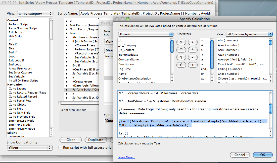

We do have it set up that way by design, and it is a bit tricky to figure out where it's happening. The script:
Apply Process Template ( TemplateID , ProjectID , ProjectName ) { Number , AvoidWeekends }
Is calling the script:
Create Edit Delete Event ( SourceNo ) { Operation , Hide, DateStart , DateEnd , TimeStart ... }
at the bottom. The parameter used when calling this script needs to be adjusted as below, so we assign the date even if the box is checked:
Apply Process Template.png (256.62 KiB) Viewed 10466 times
That should do it, but let me know.
PostPosted: Wed Jul 13, 2011 5:03 pm
Thanks Jason, I have found it and changed it. Its sometimes quit difficult to find a certain action in the kilometer long scripts.
