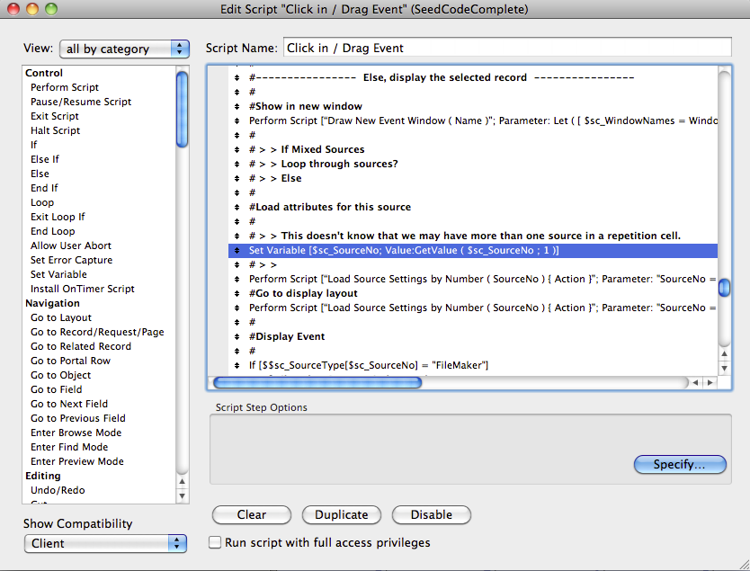

In the script:
Click In / Drag Event the script determines which source to search by which event is on the "bottom."
That part of the script is highlighted here:
You could add some logic to see if there are both "1s" and "2s" in $sc_SourceNo and if so, then set it to the "session" source number rather than just grabbing the "bottom" one.
something like:
If ( ( PatternCount ( $sc_SourceNo ; "1") and PatternCount ( $sc_SourceNo ; "2" ) ) ;
//variable contains 1s and 2s use the "session" source number
1 ;
//just one source, use the bottom value
GetValue ( $sc_SourceNo ; 1 ) )
