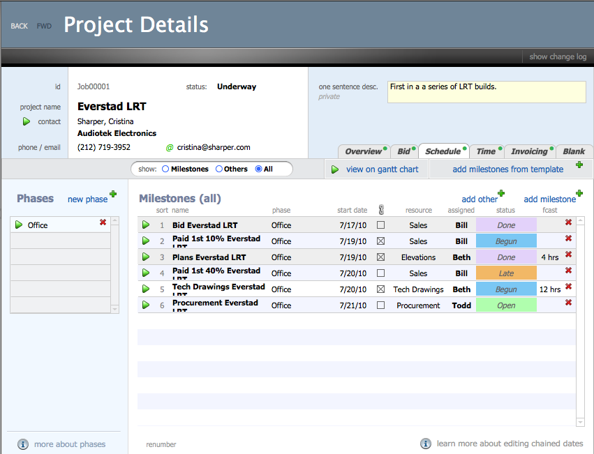

Do you have 50 date fields in the table? Ideally in a relational database we would to store that information in a separate table and have it relate back to the main record. I'm guessing that each of these dates represents a certain status/milestone of the main record. So when you create a new primary record, yo could have a script create the 50 related event records (in a portal?) and assign them the appropriate status. You could then fill in the date values in the portal of events, and those are what will sjow on the calendar.
For example, in SeedCode Complete we have projects, but the schedule is defined in a portal of related events, and they are what you see on the calendar. Since they're all related back to the main project, it's easy to have project information show up for each event when in the calendar.

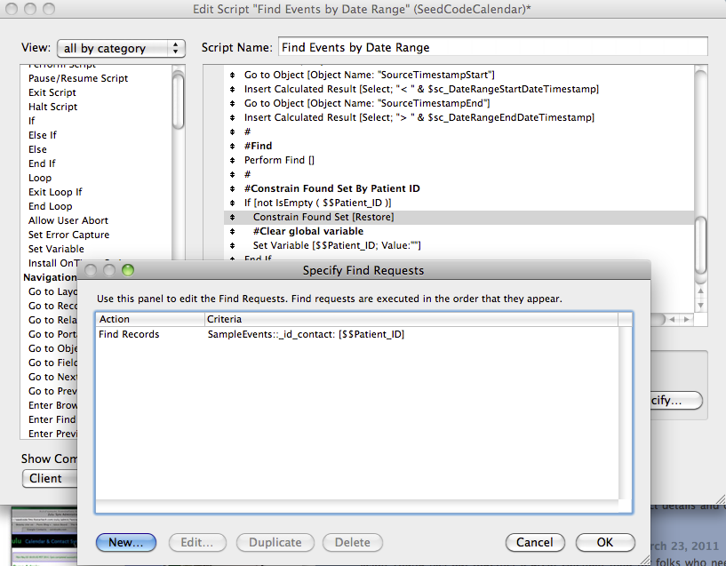

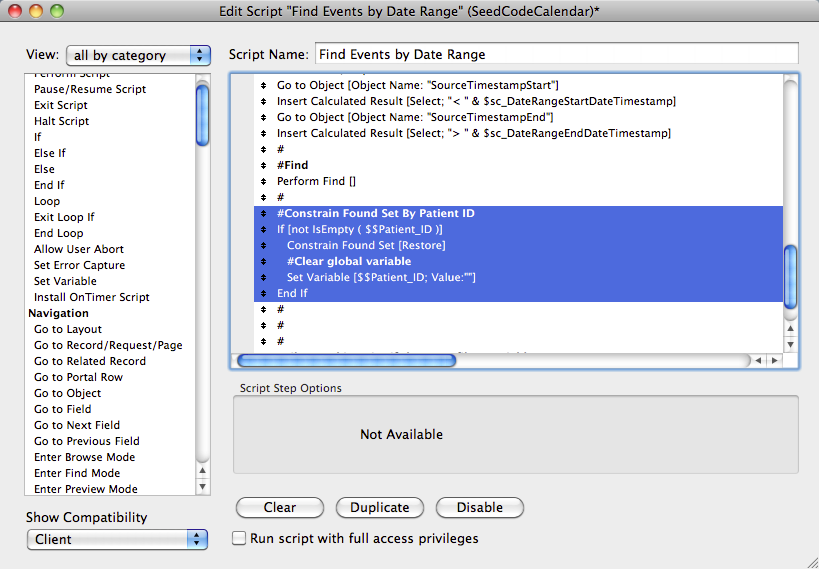

PostPosted: Thu Jul 14, 2011 7:06 am
Hi Sohala,
There's several ways to do this, but this is probably the easiest. When you press the button / run the script from the patient layout, set the patient ID to a global variable, something like:
$$Patient_ID
Then, near the end of the script "Find Events By Date Range," before the script "Apply Filters to Found Set:" add a script step that constrains the found set by the patient id. I've attached a few screen shots to point you in the right direction:
