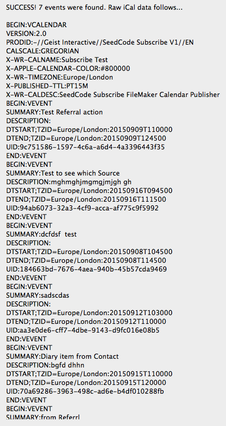

First attempt to implement Subscribe and all seems very simple, except the dates/times of the events appear to be the timestamp the url is subscribed to rather than the dates in the vent records.
A setup test shows things apparently correct, I can see the timestamps in the VCalendar to be as expected ( e.g. DTSTART:TZID=Europe/London:20150909T110000 ) - see attached, but in Google all 7 events have a start and time of 5.15p today, and iCal has them at 17.17 - actually correct that - iCal now has them as 17.30 - I guess when it refreshed!
I am using essentially the SampleEvents table from DayBack with duplication of the timestamp calc fields without the GetasNumber and set to be timestamps not numbers for the timestamp fields
What have I missed or done wrong?

PostPosted: Tue Nov 10, 2015 5:33 pm
Update for All,
I sent Dan the URL, and it worked perfectly for him.
24 hours after my initial post my Google calendar had updated itself and was showing correct dates and times. The iCal one was not though, all entries were moving as one to the last refresh date/time.
I deleted the iCal calendar and created a new one with no changes to my setup file and it is now behaving as it should.
No idea what was wrong, but clearly nothing to do with Subscribe - maybe a glitch with iCal?
