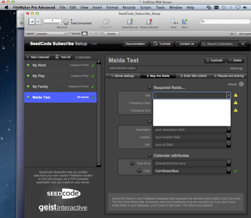

Just getting started with Subscribe so I gather I'm missing something. I can't get the engine to generate lists of fields to map.

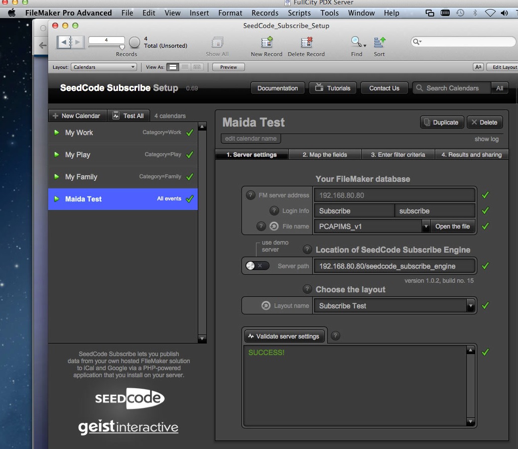

I've got all green check marks on my setup (see below) but I can't get any of my fields to display in the value lists.
The fields are indeed on the layout specified.
Server Settings Check Out
Null VLs
Any insight would be great -- imagine I am just missing the obvious.

PostPosted: Tue Feb 11, 2014 10:27 pm
HI Maida,
Thanks for the screen shots. Any of the layouts or fields in your FileMaker file contains a period (.) or quotation mark (") in its name?
Only other thing I can think of is that you have a layout folder with the same name as the layout you selected.
That help?
Posts: 13
Joined: Fri Dec 13, 2013 12:02 pm
PostPosted: Wed Feb 12, 2014 10:21 am
Thanks for the quick response John.
I figured this out: I had neglected to create an xml and php-enabled account ("Subscribe") in the other files in the solution. So I could see the layout, but not the data (separation model). I should've tried to just log in as the Subscribe user and then this would have been obvious.
I hope this post helps other people who might be working with multiple files (SeedCode Complete!) as I was.
PostPosted: Wed Feb 12, 2014 10:58 am
EXCELLENT! Adding it to the docs right now. Thanks, Maida!
