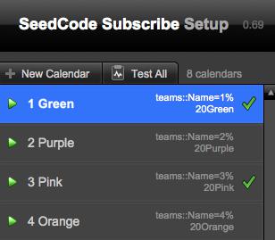

And a second issue please:
In the calendar list on the left of the SeedCode Subscribe Setup I have green ticks next to two of my 8 calendars. They all seem to be working (albeit with colour issues!)
What does this mean please?
PostPosted: Thu Oct 31, 2013 12:34 pm
Only the colors marked as active are known to work with SeedCode Subscribe. To get the green check mark for each calendar in the list, select it and click the "Validate Server Settings" button. If all of your settings are valid, the green check mark should appear.

jeffalmquist wrote:To get the green check mark for each calendar in the list, select it and click the "Validate Server Settings" button. If all of your settings are valid, the green check mark should appear.
This doesn't seem to be the case. The settings are the same for each calendar, they all work, but only some have the green check mark.
