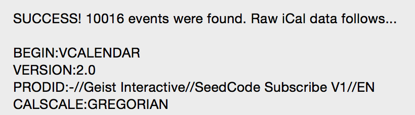

PostPosted: Tue Apr 19, 2016 10:02 am
Hi Rob,
Thanks so much for the additional info. I still think it's likely that something else is the cause of the issue here, not a record limit. We've tested thousands of records before, and I just successfully tested the setup for a calendar with over 10,000 events.
Are you seeing any info or an error message when testing the setup fails? The error message should hopefully shed some more light on the issue. Also, I would do a search for any empty values in your DateStart field. If there is one record in the found set with any empty DateStart, it could cause issues when testing the setup.

Thanks for the prompt follow up, Dan. Hmmm...okay, that pretty much puts the record limit issue to rest. At least it confirms that many more than 1000 records are supported. So...I still wonder if it might be hardware related. My test server is an old Mac Mini that I've upgraded. It's an Early 2009 model with a 2 GHz Core 2 Duo, 8 GB of RAM, and an SSD, FYI.
