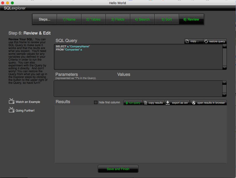

When I run query nothing shows in the webviewer. I can copy it and data is there. I can open results in web browser and it works. The version is 1.32 as is currently downloaded from your site. Filemaker 17.0.7.700. fmurlscript is on.

Is the webviewer completely blank, or is there a message showing (maybe a screenshot would help)?

Sample Screenshot

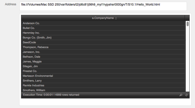

It works when creating a webviewer and putting the address to the file in it.

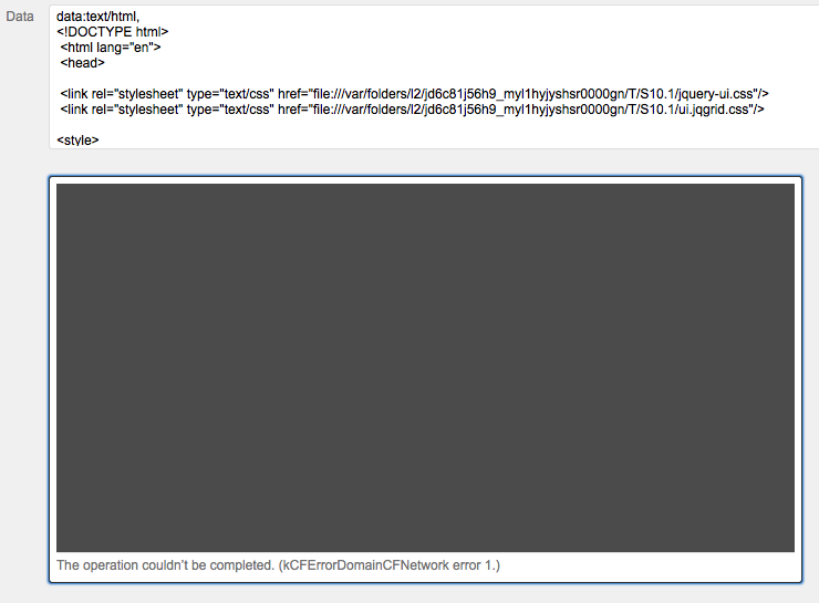

So I grabbed the $sc_webviewer data from the Data Viewer after halting the Script Debbuger on line 355.
Pasted into a field and pointed to the webviewer, the one I had created to test the file, and it did not display. After doing a reload on the portal the error message appeared at the bottom.

Thanks for the details, George.
Doing a Google search for that error shows a lot of different people running into this in Safari 12.1 when opening HTML code from local files, which is what is happening in that web viewer. Pretty much all of the forum posts say that it works just fine if they export the code to an HTML file and open it, which is what's working for you with this too.
Unfortunately, it sounds like an issue with Safari 12.1, so you'll need to upgrade to a newer version of Safari to fix it, which in turn means you'll need to upgrade your operating system to High Sierra or above.
