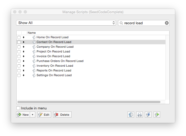

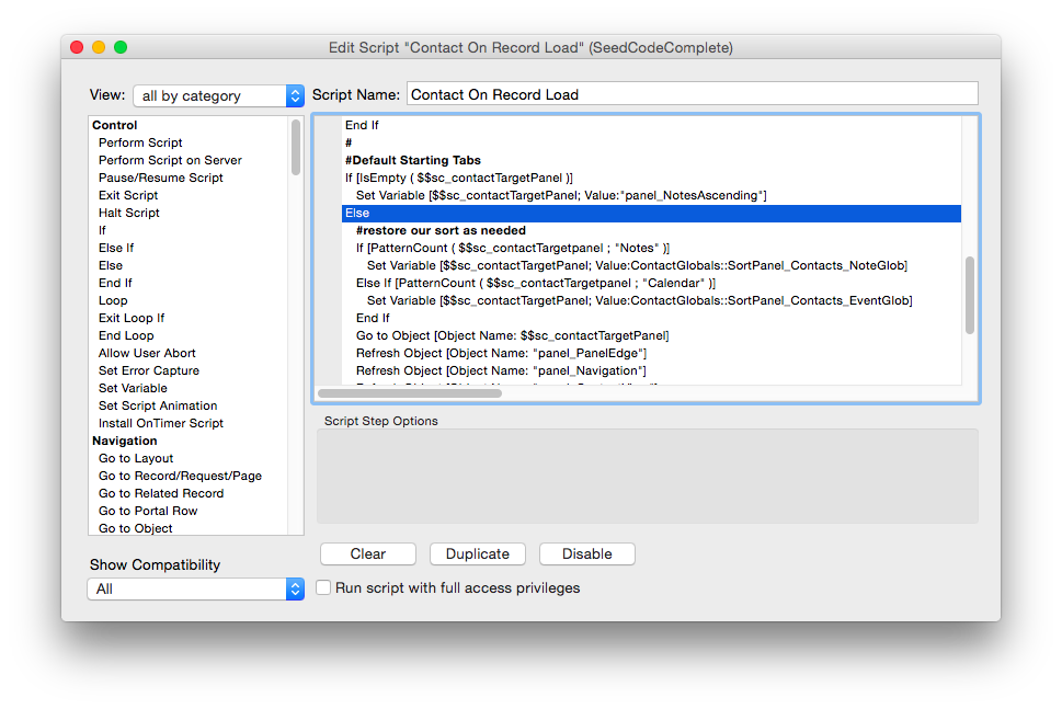

I finally had a chance to look at this and the easiest fix is to replace the Else IF line in the Record Load script triggers with just an IF. This forces the trigger to go to the last panel, regardless of what it "thinks" is the front panel.
Screen Shot 2015-03-15 at 12.35.54 PM.png (149.6 KiB) Viewed 20179 times
Please make that change in all the On Record Load script triggers and you should be all set:
Screen Shot 2015-03-15 at 12.38.56 PM.png (66.75 KiB) Viewed 20179 times
