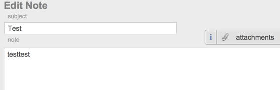

After entering text in SC13 notes the returns are stripped and all lines run together. Not sure is this is related to FM13 or Mac OSX. Have not tested on Windows yet.
Here's a sample of two separate lines concatenated into one:

There's a custom function called SeedCode_CleanText() in the SeedCodeModel file that's used in the auto-entry calc in the "Note" field in the "Notes" table. It removes any text formatting, leading or trailing spaces and carriage returns. You can edit or disable the auto-enter calc for that field, or if you have FM Advanced, modify that custom function to suit your needs. I think instead of stripping carriage returns, I would replace them with a space, or an ellipsis ("..."). HTH -Jeff
