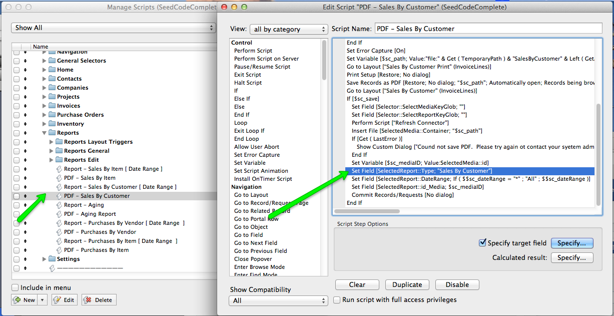

Still working through making changes to the reports. My immediate problem is renaming the saved View from History report name from Sales by Customer to Totals by Client. Made the change in script PDF - Sales by Customer, Set Field [SelectedReport::Type; "=Sales by Customer". Just changed Sales by Customer to Totals by Client but now nothing is saved to the View From History portal. What am doing wrong here?

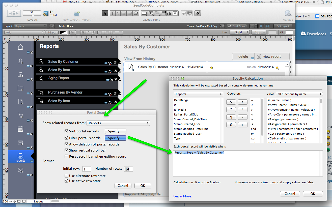

I don't think I explained very well. I am trying to change the name of the report saved in the View From History section of reports. I would like to have report names saved as Totals by Client instead of Sales by Customer.
How can I do this? TIA -Ken
Re: Custom Reports
PostPosted: Fri Dec 26, 2014 9:54 am
by John Sindelar
Hi Ken,
Thanks for the clarification. This is easy to change.
Each of the reports has it's own "PDF" script shown to the left in the screenshot below. Each of these has a line that sets the name of the report into the "type" field, shown to the right in the screenshot below. =)
The only trick is that the report portals on the "Reports" layout decide which history records to show based on a filter on this field. So if you change the name set into the "type" field you'll also want to change the portal filter criteria shown here:
Each report has it's own panel / portal and this video shows how to get to those if you're new to editing these layouts: http://www.seedcode.com/pmwiki/index.ph ... ddenPanels
