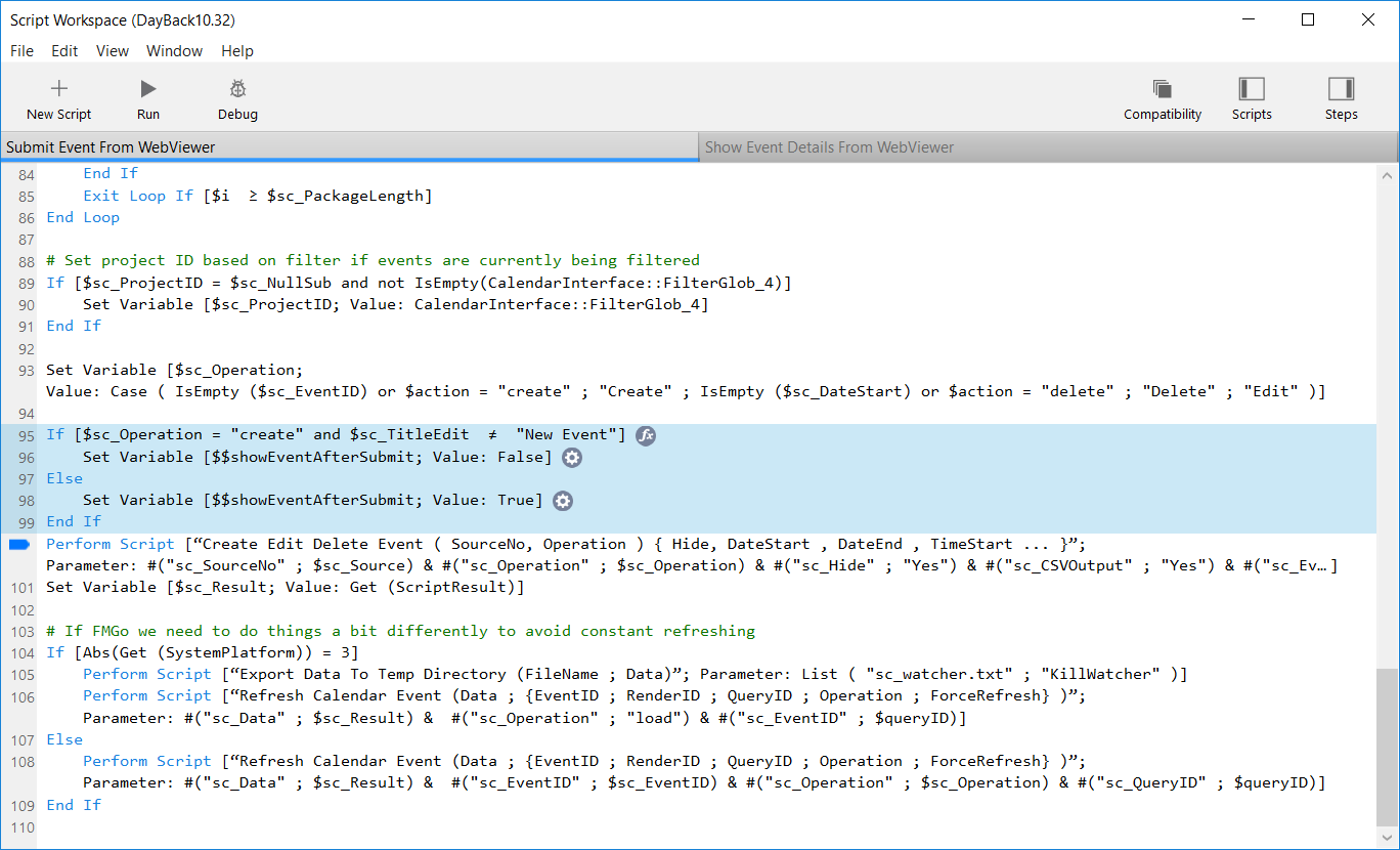

While we don't have a setting for this in the calendar, you can modify the following scripts as shown in the highlighted lines of the screenshots to flag these duplicated events where the title is something other than "New Event", to not display the popover after the event is created:
"Submit Event From WebViewer"
Submit Event from WebViewer.PNG (72.16 KiB) Viewed 15886 times

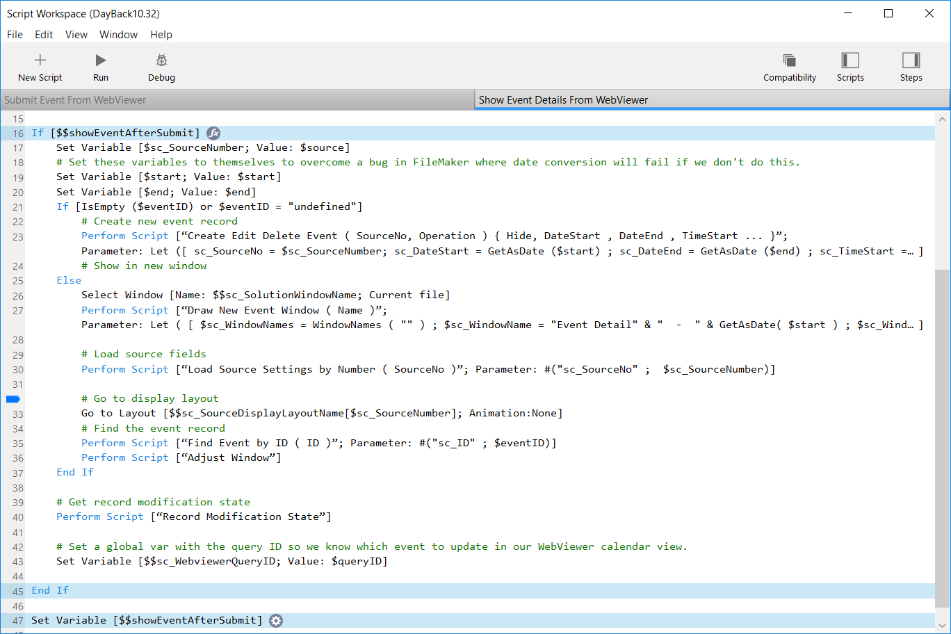

"Show Event Details From WebViewer"
Show Event Details From WebViewer.PNG (72.16 KiB) Viewed 15886 times
Let me know if that helps!

Oops - I spoke too soon. The modification suppresses the display of Event Details windows under all circumstances (not just following an Option-Drag duplication). E.g, I click on an appointment and no Event Detail window appears.
Let me double check to ensure that I got everything right...

Sorry about that, wsmii.
We need to explicitly check for the $$showEventAfterSubmit value to be False, so change line 16 in the "Show Event Details From WebViewer" script to be "If [$$showEventAfterSubmit ≠ False]" and it should work as expected.
You could also play around with the logic a little to set the variable to True by default if you'd like, but this should work.
