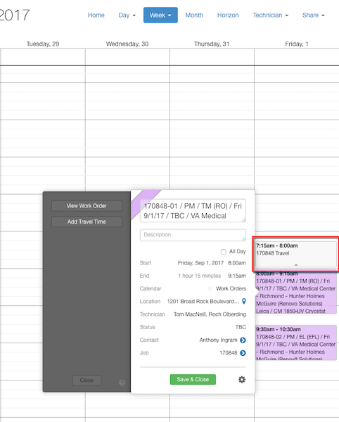

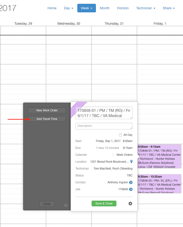

The calendar I'm working on implementing schedules technicians to service locations. We have a custom action to be able to add travel time to the beginning of a work order. (All the smarts is done with existing Google API's we currently have in the application).
I'm implementing the travel time as a separate calendar. Same table of data (the work order), but separate fields for the travel start/stop fields.
When the "Add Travel Time" custom action is clicked, it runs the Google API to get the travel time for the selected tech(s) to the service location and adds the travel event to the calendar. I then have to refresh the entire calendar to get it to appear. The popover stays on the screen throughout the entire refresh and doesn't close. I would like it to close to show "completion" of adding the travel time event and not be the main focus to the user since they've completed that process.
It would be optional of course for the developer to close the popover (or maybe even just the custom action tray) , because I could see other use cases where keeping it open might be preferred as well.
A few screen captures of some test data...
