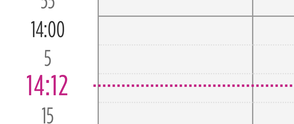

Re: CSS??
PostPosted: Sun Dec 11, 2016 5:57 am
by rwu2359
Screen Shot 2016-12-11 at 14.12.25.png (27.34 KiB) Viewed 13440 times
Thanks John... just the help I needed..
all lovely.
