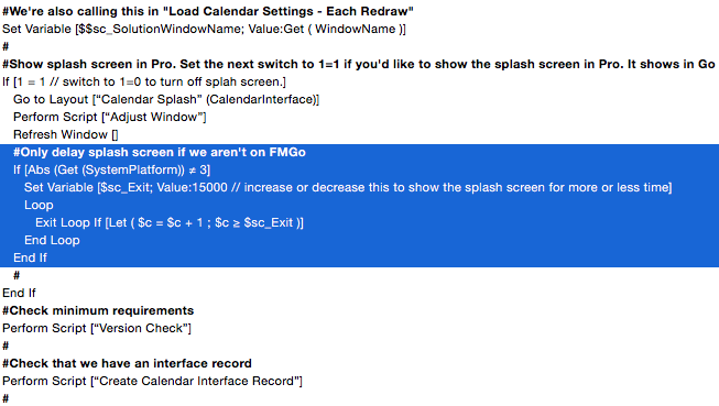

We made two small changes to scripts in this version to prevent FileMaker Go 14 from crashing when launching DayBack. Please make the following changes...
In the "Upon Opening" script please wrap an if statement around the code block that delays the splash screen as shown in the screenshot below:

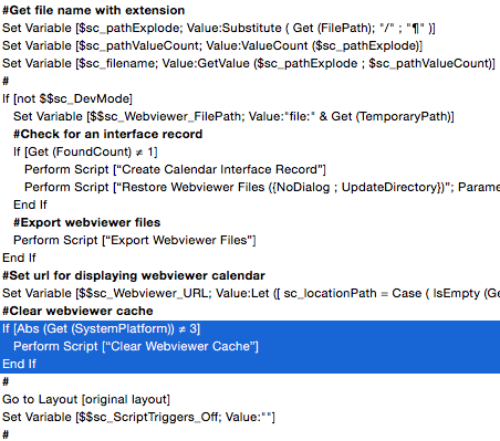

In the "Get Webviewer Calendar FilePath" script please wrap an if statement around the script step "Clear WebViewer Cache" as shown in the screenshot below:
That's it, enjoy DayBack 9.52.
