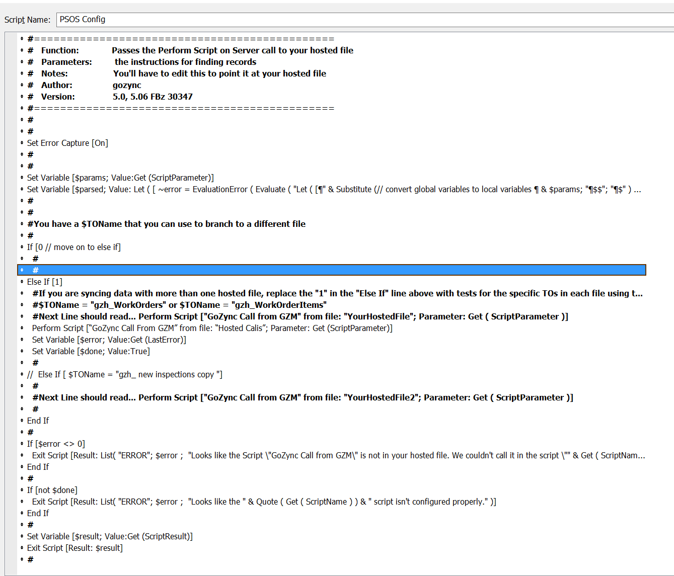

My only thought left regarding speed was to make sure I'm using PSOS. I understand it happens automatically when it can but I'm wondering if a 1 or o in the wrong place while I was setting things up may have turned it off. What should setup look like to ensure this is working?
- screen shot of PSOS config from GZM
- Psos config.PNG (67.08 KiB) Viewed 81601 times

Thanks so much for the additional info and screenshot. Your PSOS Config script looks good, so the issue should not be with your script setup
