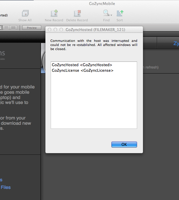

When the error occurs i am seeing the following
Error Msg 1.png (111.39 KiB) Viewed 31212 times
so i think the GTRR error is caused because the mobile file is dropping the connection with the hosted file. Oddly this is happening even if i have a database on the same server open.

That message you're seeing is just FileMaker telling you the hosted files were closed because your network connection was lost. GoZync is designed to revert any incomplete "transactions" (partial record syncs) when you lose your network connection fr any reason in the middle of a sync routine. Are you saying this is happening at the same point in the syncing process every time?

i know that every time the failure occurs it is between the Check network connection script and the "pull meta data and settings down from host".
the script that returns with the value for the filepath of the hosted file completes and returns the correct fmnet:/(ip address)/GoZyncHosted.fmp12 value. Then after a short pause you get the Communication with the host was interrupted message. It is interesting to note that the message is reported from the GoZyncHosted file on the server as can be seen on the screen shot below.
