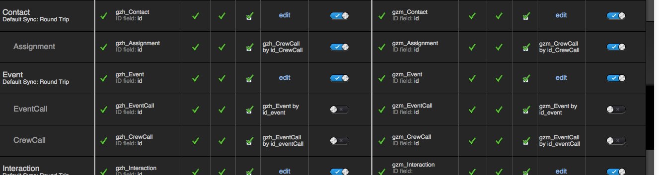

Possible Bug. Note in attachment that Assignment has not sorted properly. It is a child of Crewcall, Crewcall Child of EventCall, which is a child of Event
And yes, I do know that my current setup may be sync overkill. Still digesting all the options....

Re: Table related to more than one parent
PostPosted: Tue Aug 20, 2013 7:27 am
by jeffalmquist
