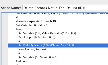

Re: Deletes not being 'pulled' down to the device
PostPosted: Mon Feb 11, 2013 2:12 am
by brian.curran
Would I change the line in red text below somehow? I can't work out where I need to put the & "==" & before the ID...
#remove the records from this TO #------------------------------------------------------------------------------
Set Variable [ $CheckZyncDB; Value:False // this gets set to true later if required ] Enter Find Mode [ ]
Set Variable [ $FieldName; Value:/*
Returns the fully qualified name of the PrimaryID for a given TO
The graph must be constructed correctly, ie attachments to GoZync must be ok */
Let(
TOName = $TO;
info = RelationInfo ( Get( FileName) ; "GoZync" ); p=Position(info;"Table:" &TOName&"ΒΆ";1;1); p2 = Position ( info ; " = " ; p ; 1 );
info = Middle(info; p; p2-p);
c = ValueCount(info)
GetValue(info; c)
#create requests for each ID Set Variable [ $i; Value:1 ] Loop
Set Variable [ $id; Value:GetValue($IDs; $i ) ] Exit Loop If [ IsEmpty ( $id ) ]
Set Field By Name [ $FieldName; $id ]
New Record/Request
Set Variable [ $i; Value:$i + 1 ]
End Loop
#delete the last empty request
Delete Record/Request
[ No dialog ]
#do the find
Perform Find [ ]
PostPosted: Mon Feb 11, 2013 7:27 am
by John Sindelar
Thanks for the screen shot, but that's not it: make the change shown in the blue line below.
Enjoy!
PostPosted: Mon Feb 11, 2013 11:32 am
by brian.curran
That works great, many thanks John...
